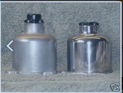

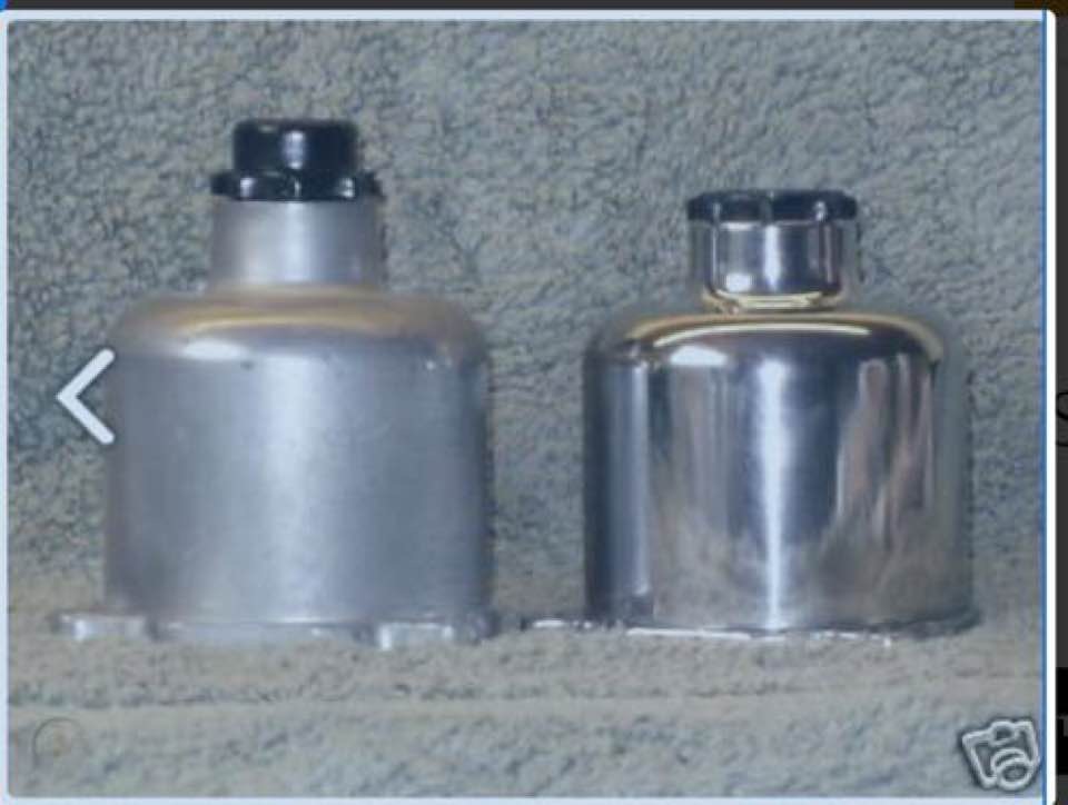

Hopefully you can help I have an MGB V8 which I want to fit SU on an aftermarket copy of the trouser manifold unfortunately the carbs are about 10mm to high.
When looking at the internet noticed a firm selling shortened SUs. I could do this my self if I knew the procedure. Anyone know what’s required. I’ve attached a picture and there description
You are looking at a HIF 44 SU Carb. The carb has been modified to suit a 1275cc MG MIDGET / HEALEY SPRITE The Dashpot and Piston have been machined to reduce the overall height of the carb and it is fitted with a flat topped damper. This reduces the carb height by approx. 15mm and allows fitting to most aftermarket inlet manifolds.

You can get different dampers, e.g. http://sucarb.co.uk/damper-19098.html. That alone should gain close to 10 mm reduction in height. The threaded section at top is machined slightly lower, moderate machining should suffice. Same amount from the piston top if even required.
A bit hard to tell but looks like they took some material off the flange also. There is not that much to begin with, I would not touch that at all.
All this top of my head, it´s been some time since the last time I had a HIF apart.

Thanks for the reply minorv8. I have ordered 2 of them which would probably be fine but the Dashpot comes up through the hole hence the deeper damper top. I guess I will have to machine the Dashpot top to get full travel is that okay to do?

Do you mean the piston, like this ?
Some pistons have circlip, some don´t. I think that HIF44 does whereas HIF7 does not. Anyway, check if you have enough travel when the carb is assembled. You can machine the dashpot top lower, there is plenty of thread for the damper. If required you can take a same amount off the piston top. You may also need to adjust the length of the damper in case it bottoms out in the piston bore and prevents full travel.
Have you considered machining the intake flange/trouser manifold to lower the whole asembly ?

Yep that’s the one, I’ve been looking at shaving the manifold could be possible shortening the SU would be easier I’m going to shorten the Dashpot and use a flat top damper and see how it works. If it doesn’t run well it’s not to painful to return to normal.
