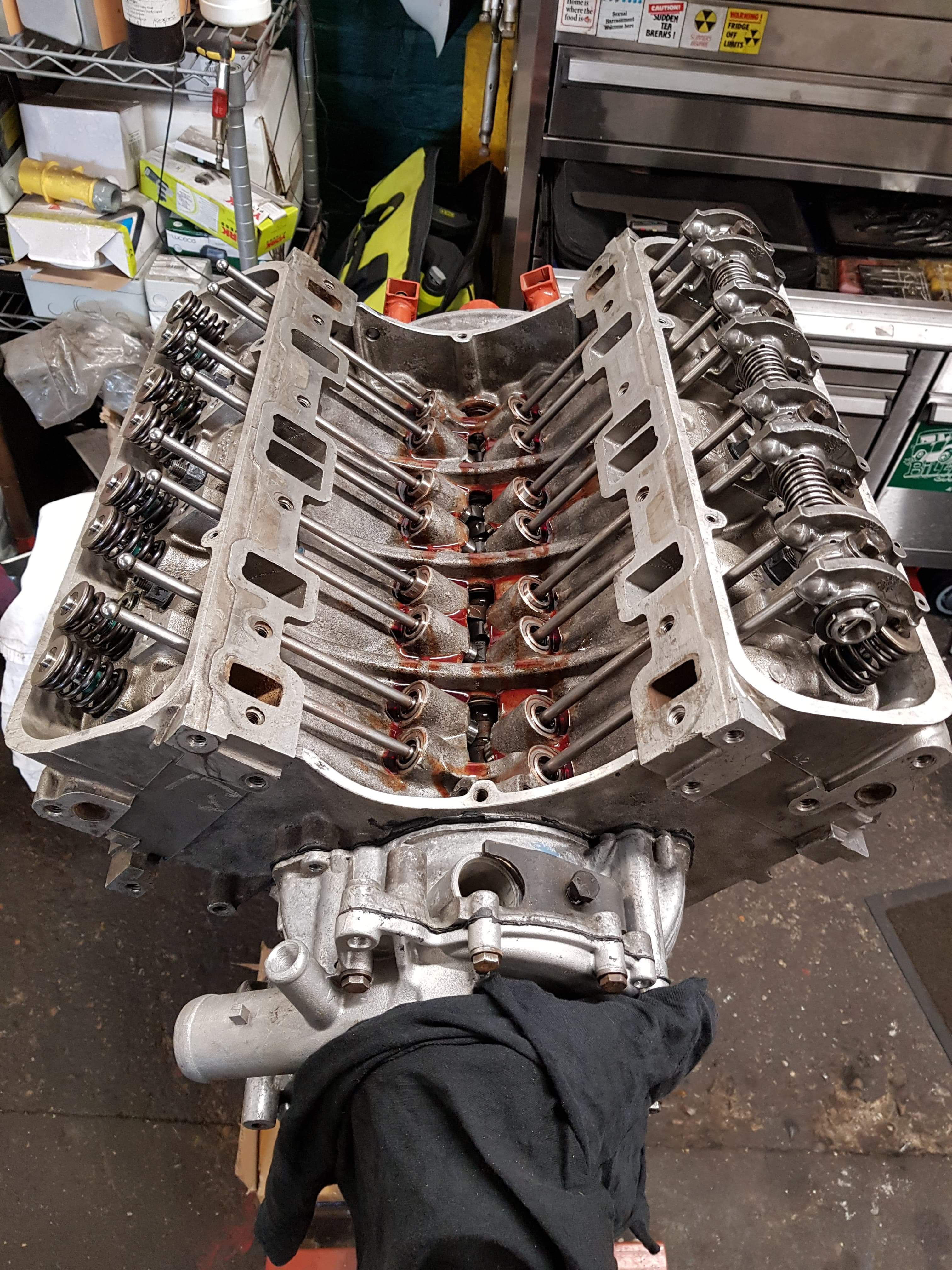

So, a "few" years ago I decided to drop a v8 into my Land Pig.
So an EBay "of course it runs" purchase saw me with an early 10.5:1 3.5, to be fair, it did run although I'm not sure how as no.5 journal was a good mm smaller than all the others.
Move on a "few" years and many more Ebay purchases has me with a complete engine bought in pieces.
It's been interesting and certainly a challenge, but I'm having fun.
This is where I started.
And this is where I am now.
Posts: 5078
Re: 1970 S2a Land Pig engine debacle
That is a car type front cover I think. If you were able to get a Range Rover one, it lifts the water pump up considerably which might be useful in a Landie.
The whole front end ancillaries change though, so you should get another complete engine to make sure you've got it all!!
Andys101
Posts: 9
Joined: Sun Jan 19, 2020 10:42 am
Post by Andys101 »
Yes, it's an SD1 front cover, its needed for the short waterpump as I want to keep the front end stock.
I have about 6 front covers to choose from.
Rossco
Moderator Gold
Moderator Gold
Posts: 850
Post by Rossco »
Water pumps are interchangeble
Posts: 5078
The shortest front end is the one from a P38 Range Rover, but you lose the distributor!
It's what I've done in my Landie.
Rossco
Moderator Gold
Moderator Gold
Posts: 850
Post by Rossco »
Or as an alternative you could go with an electric water pump.
I've just installed one on my latest build which is also destined for a Land Rover
Andys101
Posts: 9
Post by Andys101 »
Nice lump!
I'm going to stick with the SD1 front end for the time being but, where I go in the future is very open...
