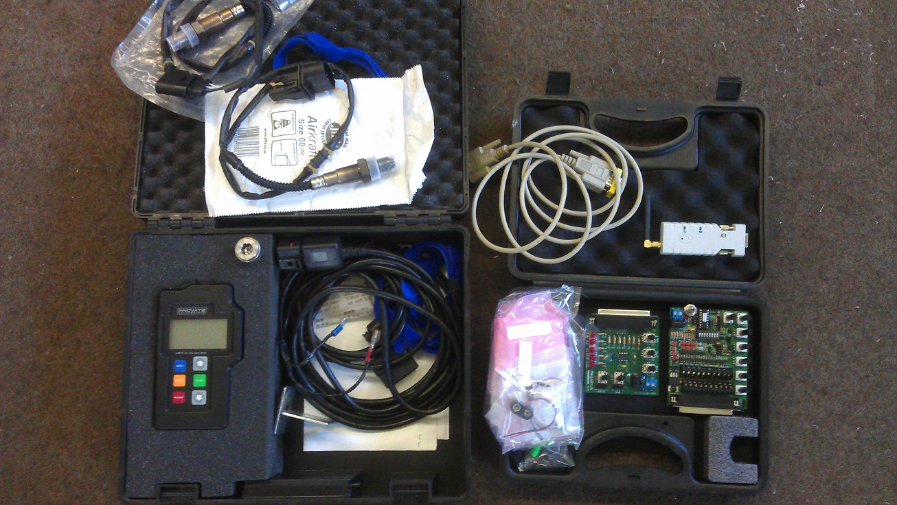

they just work and no voltage offset issues like I had with my Innovate LM2 (even grounded in the same place as MS and splitting heater and sensor grounds)
lots of glitches and freezing on initial purchase of the LM2 until about 2 firmware updates in
but as a stand alone its OK relegated to its original carry case nowadays though, but Spartan 1 and later 2 are just trouble free
