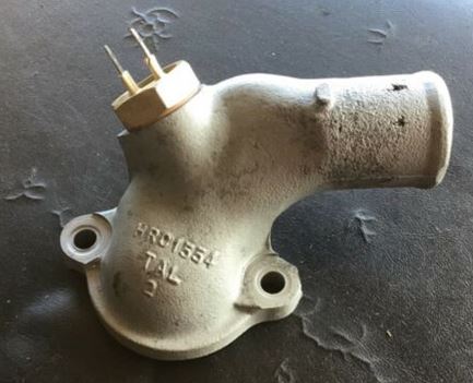

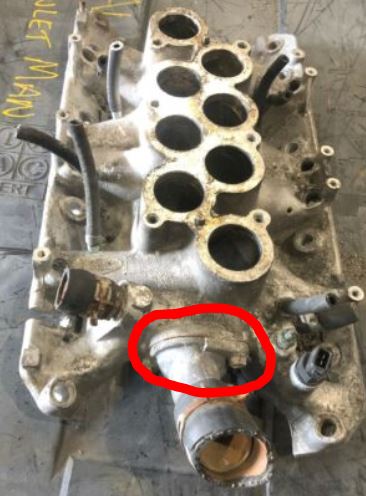

Unless Im getting gems confused (quite possible), but I dont think this is the case...The thermostat housing sits directly on the front of the inlet manifold.
Building a westfield V8
Re: Rover V8 Coolant Circulation Direction
Just did a quick search for gems thermostat housing to see if it came up with differnt types....Indeed it does!!!!. The one I have is this:
So all of the info above is based on the system I have:
I think there's some confusion here.
On all the engines, the water comes out of the top hose, down through the radiator, and back in via the bottom hose.
Then it goes into the pump, backwards into the block, up into the heads at the rear of the block, and finally forwards through the inlet manifold.
On GEMS, (and Thor), the thermostat is in the bottom hose, so what looks like a thermostat housing should be empty.
On earlier engines, the thermostat is at the front of the inlet manifold where the outlet is for the top hose.
That picture of a thermostat housing is not for a GEMS engine, it is for an EFi engine with air-con.
The heater circuit and thermostat bypass 'miss out' the thermostat and radiator, but the circulation path and direction is otherwise the same.
jenko wrote: Tue Jul 07, 2020 3:14 pm Unless Im getting gems confused (quite possible), but I dont think this is the case...The thermostat housing sits directly on the front of the inlet manifold.
On GEMS and Thor that is just an empty elbow directing coolant into the top of the radiator.
The actual thermostat (number 2) is a plastic remote housing in the bottom hose with connections to the bottom of the radiator, bypass circuit, heater circuit and pump inlet.
