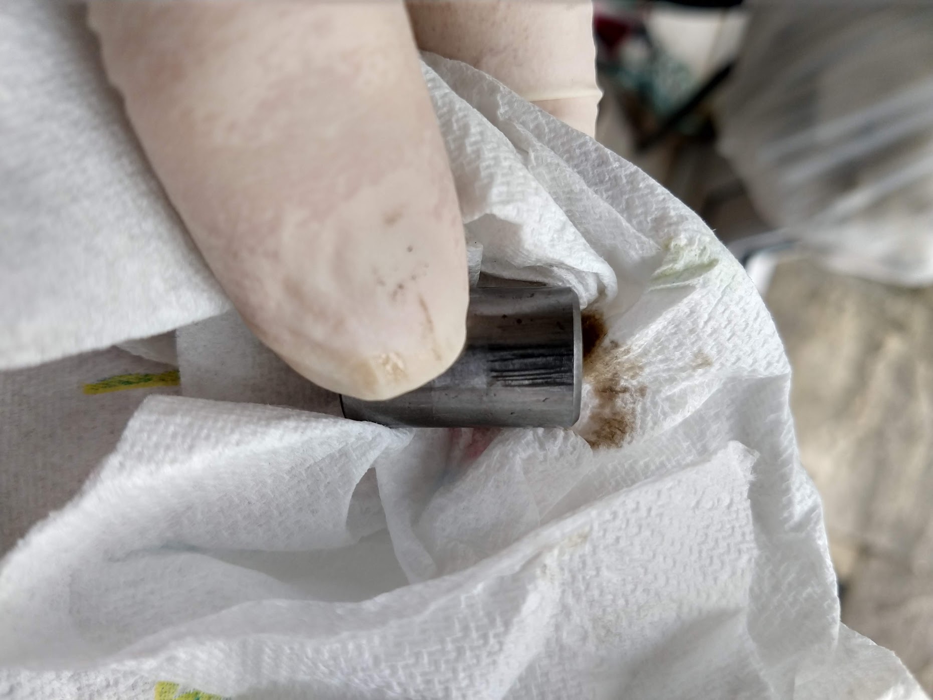

I suspect my oil pressure relief valve may be cracked open. I've just ordered a new one, any handy hints on fitting (apart from do it over something to catch the oil that will undoubtably wee out)?
Posts: 559
Re: I've got a chatty engine.
Well I got the OPRV out (which was a fun task) and it looked like this :-
I think that is not how it's meant to be. Fitted a new one and I now the oil light is out at idle. I need to give the car a bit of a razz but I let the insurance lapse this week as I thought I'd be off the road for longer. Oh well, I've got a couple of jobs to do that need the dashboard out so I'll crack on with those.
