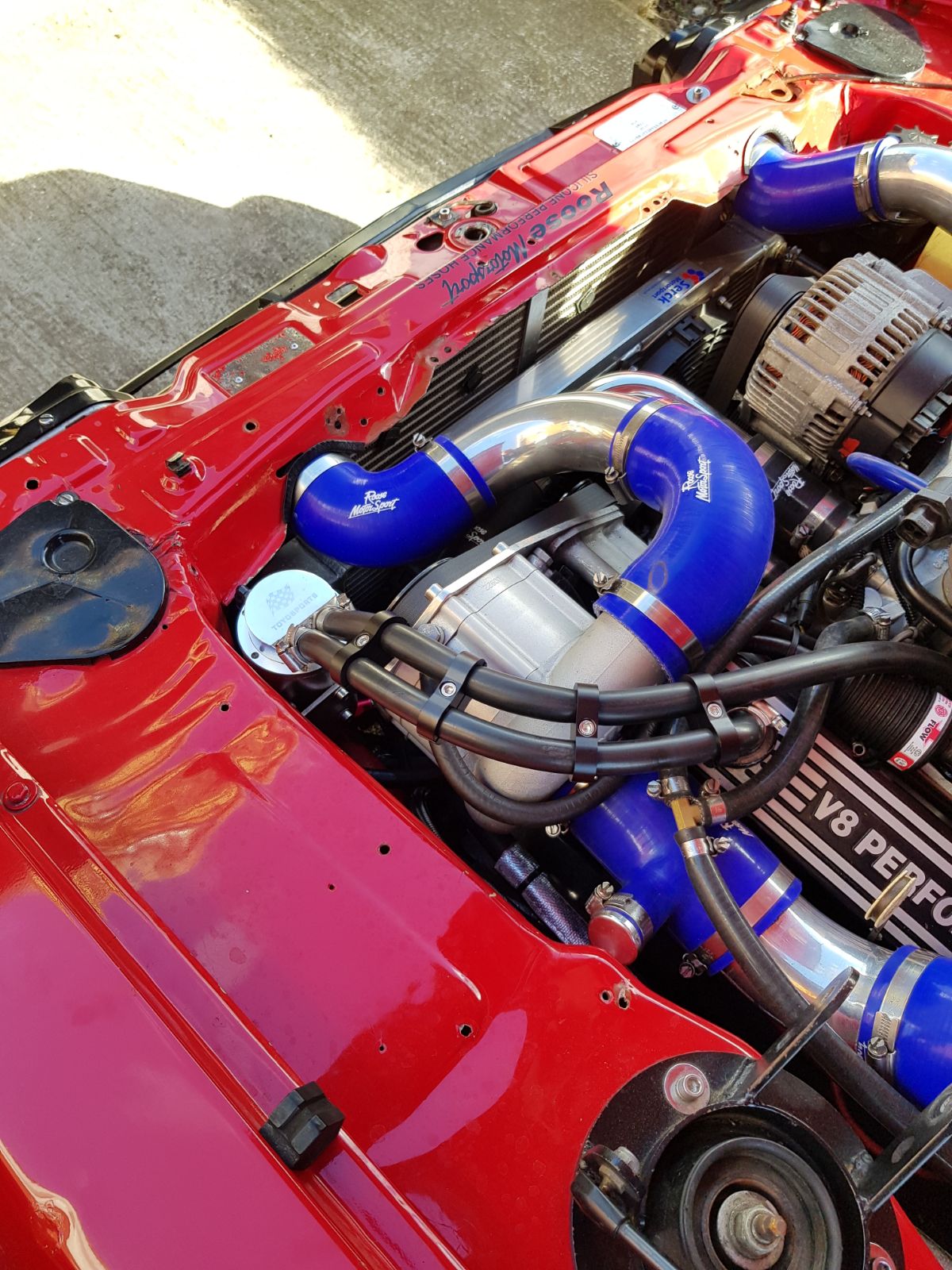

Well today the new oil resistant nitrile breather hose came,
hopefully no more split hose and fumes in the car,
along with the new hose separator clamps,
cable ties were looking a little tacky :rofl
cable ties
New hose and clamps,
