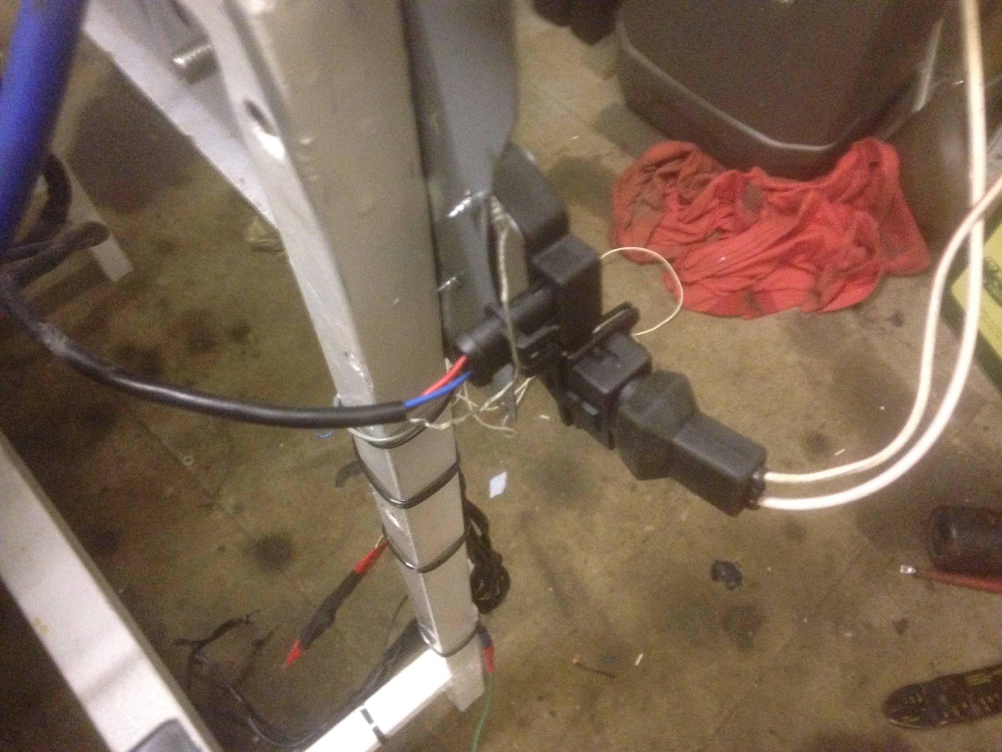

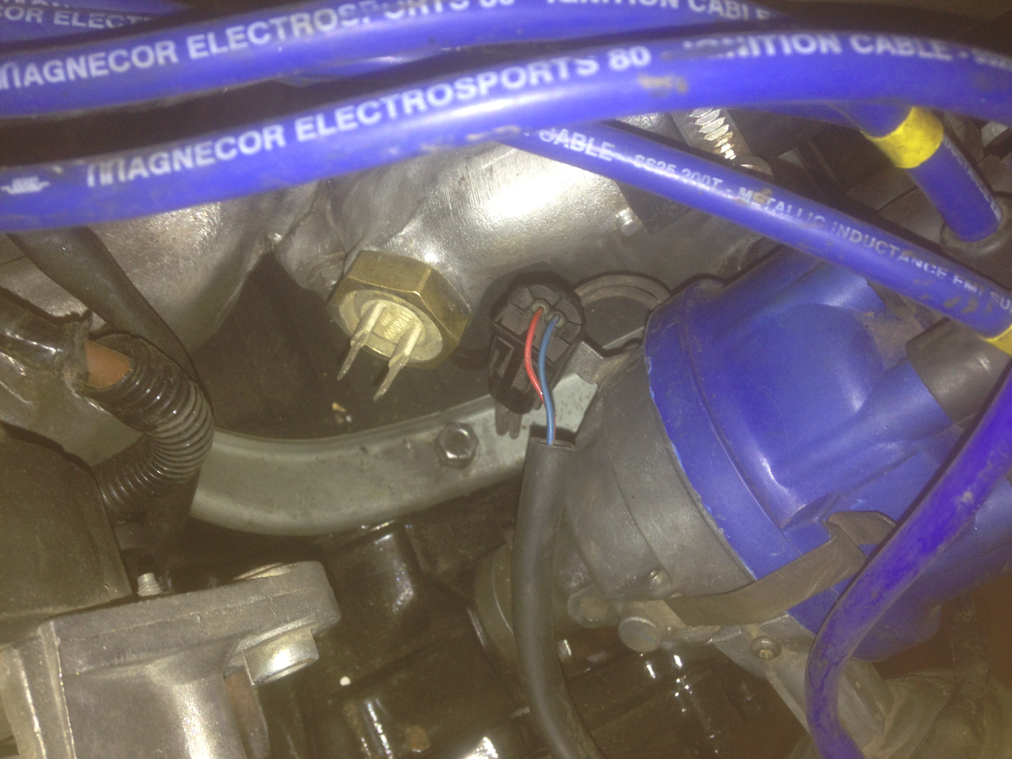

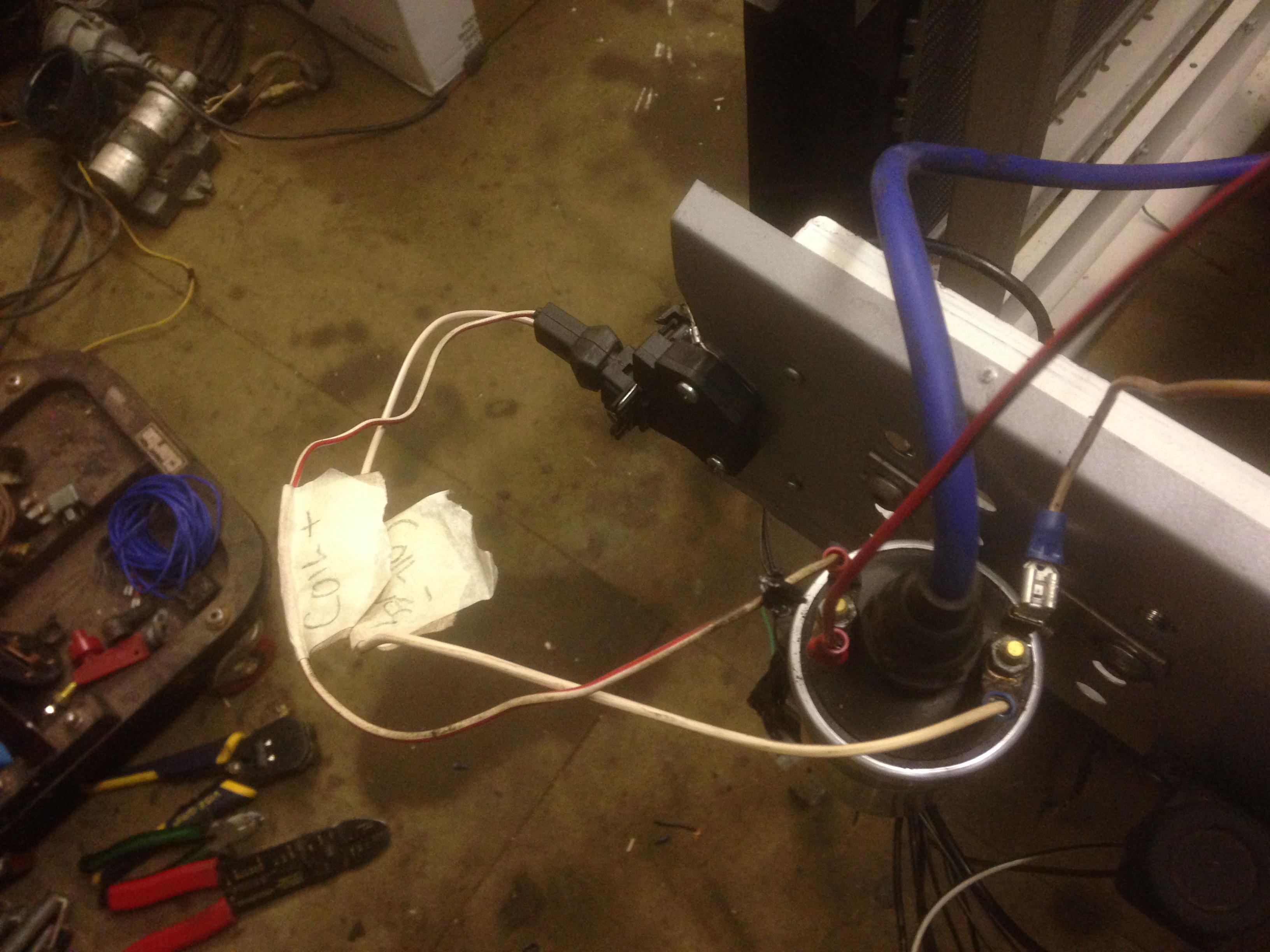

I think there should be some photos of the coil, I've stripped back the wiring got rid of the kill switch so it's as basic as it gets, the red wire to the coil is a switch live, brownish wire to rev counter, red/white to amp, white to amp, how much simpler can it get? Engine turns over but still no spark, am I doing something stupidly simple wrong? (It has been known in the past!)

Re: No spark frustration

Woo hoo, I have a spark!, not a particularly fat one but I've got one, I disconnected as much as possible and ran an earth wire direct from battery neg to the coil mounting point, it's a starting point, I'll now start reconnecting things and then hopefully get the efi working to test it then swap everything to the Holley carb setup, so that's my evenings and weekends sorted for this month!, Thanks for your inputs

It is now, perhaps the earth wasn't good enough before, i now have a decent enough spark to get the engine firing

It would appear so, the engine is on a test stand with a large earth strap to the the frame from the engine block and then to battery earth, the coil and most electrics were on a separate but attached frame, after running a earth strap from this frame to battery earth it worked
, it was so frustrating checking and re- checking, but I've come to realise over time that most automotive electrical problems are earth related
