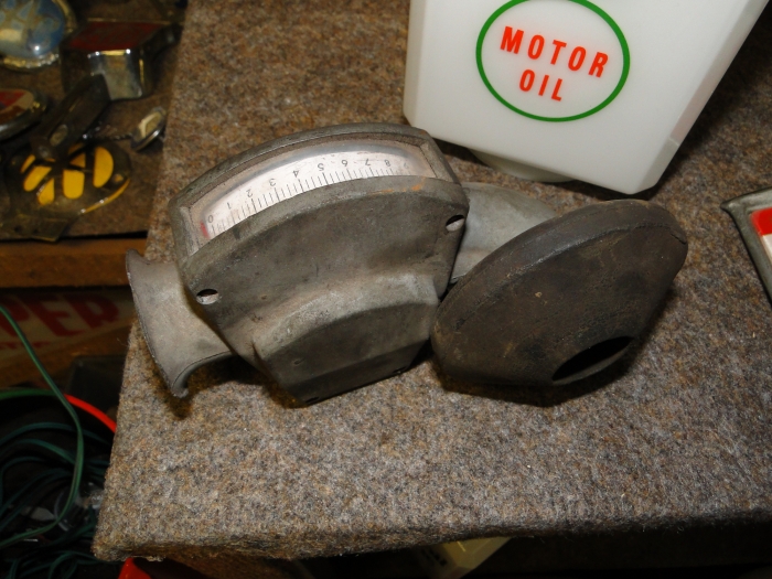

Crypton Synchro Carb Balancer.

Cheers for the replies, the Crypton looks like its built to last - I'll have a look for one and hopefully can find one at a reasonable price.
