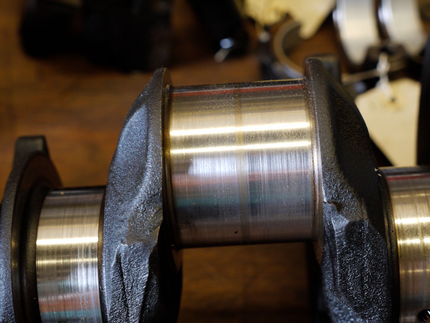

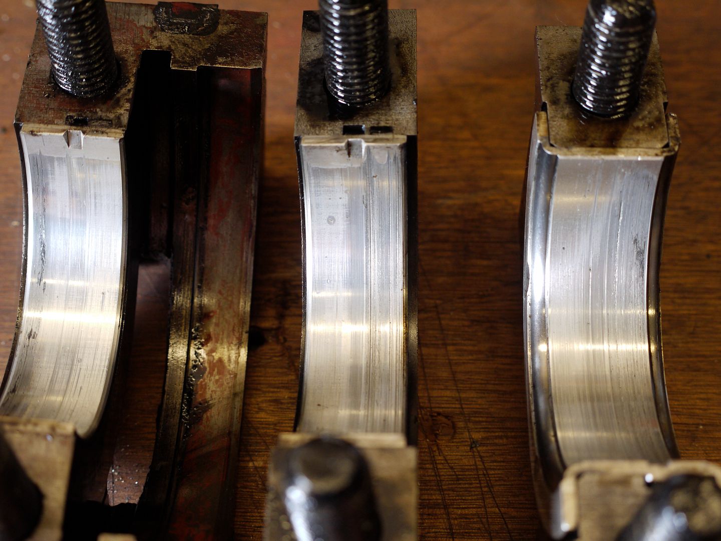

Big end shells

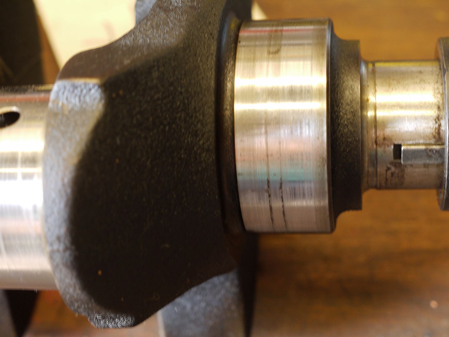

Crankshaft
[/img]http://i826.photobucket.com/albums/zz18 ... 020226.jpg[/img]
The big ends and main bearing shells are all standard.

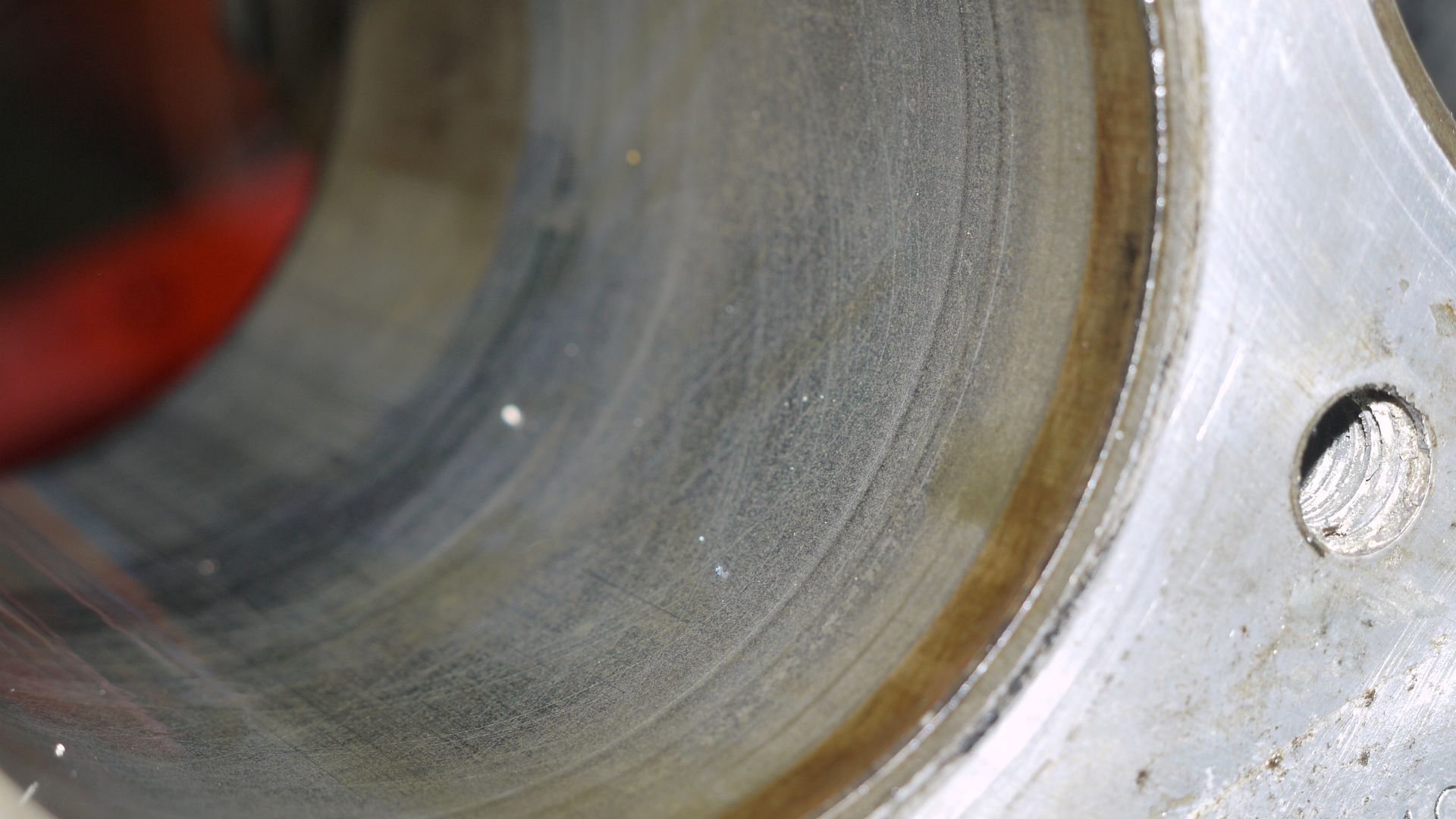

The bores
[/img]http://i826.photobucket.com/albums/zz18 ... 020229.jpg[/img]
Seemed very smooth when I cleaned the up with a rag and I only noticed the marks that the rings have made when I saw the photos. There is no lip at the top of the bore.

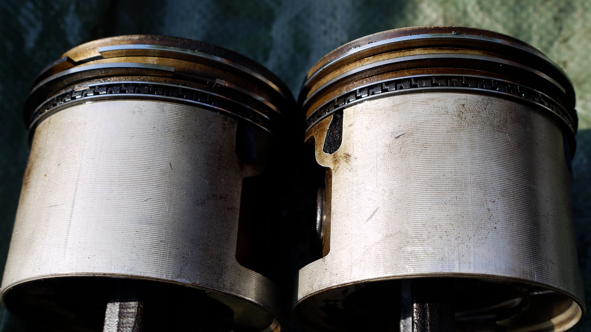

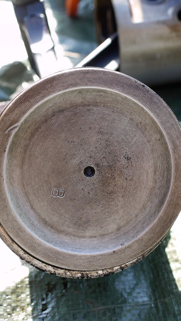

The pistons
  • http://i826.photobucket.com/albums/zz18 ... 020239.jpg[/img]

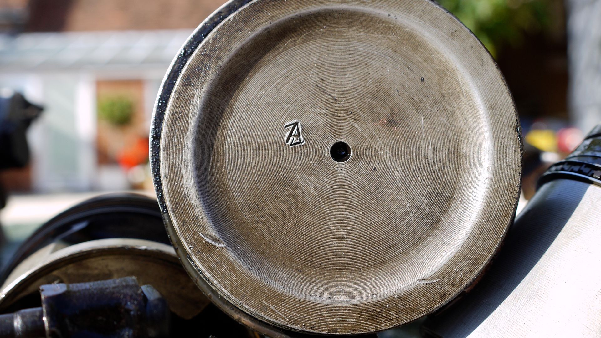

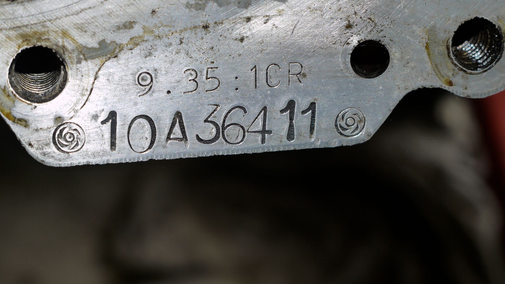

    have an A stamped on some of them and
    a B stamped on others. Again, in the absence of any indication to the contrary, I take it that these are standard. What is the significance of the A and B stamps which are mirrored with the same letters stamped onto the crankcase adjacent to each piston?
    [/img]http://i826.photobucket.com/albums/zz18 ... 020237.jpg[/img]
    In my ignorance they look quite good.
    I'm on a limited budget but think I need to get the crank reground with new shells etc. Do you think I could get away with just putting new rings into the pistons. The engine used no oil, neither did it smoke at all.

The A and B denote fractionally different sizes or grades of piston, the piston and bore fits were selected at the factory to give ideal clearances. On reusing the pistons the crucial areas are the side clearance of the rings in the grooves and the skirt clearance in the bore. The workshop manual should have the acceptable dimensions. You will certainly need a new cam and lifters as well.

bigaldart wrote:Hi,
Alan
Hi Alan
So, are you saying that the pistons could be reused subject to getting the correct size of rings? I know it's hard to tell from photos, but I would like to reuse them.
Yes, a new camshaft and lifters is on the list together with head bolts, main bearing bolts and big end bolts and nuts.
The oil pump looks newish and might have been fitted by the PO to try and gain a bit of oil pressure so I am a bit undecided about that. One good thing with this engine is that changing the oil pump isn't that big a job once its all back together - or so it seems to my untrained eye!
Ant
1958 Land Rover Series1 V8
Posts: 5078
Almost certainly OK to reuse pistons. But new rings a must. And perhaps a quick hone on the bores.

with regard the pistons, and glaze bust the bores at the minimum a proper hone if you can get it done for a reasonable price, the shells look good but the low oil pressure would make me think a regrind and set of shells would be well worth the money. New cam would be essential. pull the gallery plugs and give the oil galleries a really good brush out the cam lobes have to have gone somewhere :shock: . I would renew the oil pump internals and check all the clearances, radius the ports but otherwise leave it stock, don't fit a high pressure spring they just kill your distributor gear.

Is that mark on the piston an indication that its been hitting a valve

kiwicar wrote::whs
best regards
Thanks Mike - lots of good advice there! The camshaft wasn't too bad but I shall replace it anyway and clean out the oilways. What brush should I get for that job?
As the engine is in a S1 Land Rover and the weakest link in the transmission is the gearbox, I am not after more power, just a healthy engine!

That crank certainly a needs a grind and those bores definitely need glaze busting before a fresh set of rings are installed, if the pistons check out then re use them 8-)

Not quite sure what you mean by the pistons checking out.
This is pretty much what they all look like.

Those shells look too good to me to be the cause of low oil pressure, if they are all the same. Are you certain the gauge is accurate? The electric ones often ain't.

The shells are all the same.

I would replace the shells - they don't look that great to me, plus its in bits anyway - daft not to. If there's no lip on the crank, then I would just give them a clean with fine emery cloth.
Definitely need to de-glaze those bores.

I'd be inclined to take the crank to an expert. It may just need a polish and new shells. Most of the worn engines I've taken apart have copper showing through the shells. The scoring on the shells may have been dirt on assembly, or a lack of filter and oil changing.
DaveEFI wrote: I'd be inclined to take the crank to an expert. It may just need a polish and new shells. Most of the worn engines I've taken apart have copper showing through the shells. The scoring on the shells may have been dirt on assembly, or a lack of filter and oil changing.

I will be taking the parts to an expert - Thurston Engineering who have done quite a bit for me over the years. Not cheap but really good.
