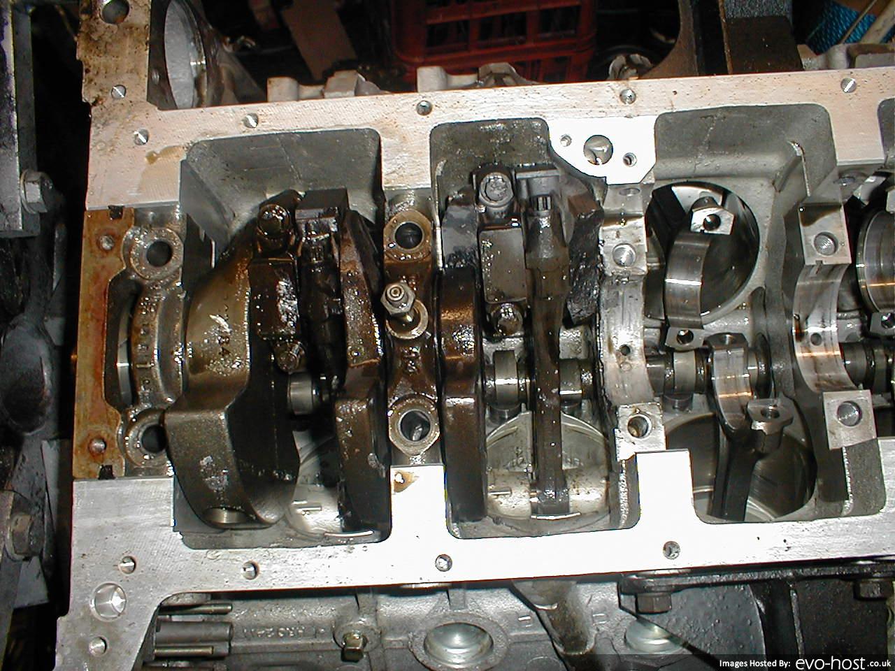

I did the same. It depends on how long you ran it for!
After about 5 minutes I could hear some squeaks starting, and after a minute or two more I shut it off.
It needed the crankshaft regrinding!

On the arrangement I ran at the time, then there was absolutely no oil circulating in the engine, but the pressure light went out. All the oil was being dumped straight back into the sump from the pressure relief valve.
