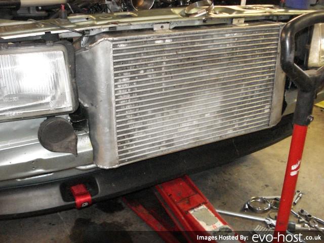

I'm still having cooling issues with this huge cosworth intercooler in front of my rad.
1: What is the smallest intercooler I can safely go to?
2: Or is there other options I can look at?
3: Or do I need an intercooler at all?
As always you guys are the best to ask :nw :nw
JP.

I cannot believe the intercooler is the problem.
I can believe the water rad may be the problem, or some other issue.
Ive a 4.5" thick intercooler covering almost the entire frontal of my water rad, and have no issues at all with cooling. My water rad sits about 2" directly behind it, although does extend maybe 1.5" lower than the intercooler.
However....as a relatively cheap test. You could buy a cheap 4x4 Cossie intercooler which is only 5-6" tall and fit it in place of the larger unit. Think they go for £50 or so on egay and should almost be a straight swap for you.
Some pictures of the two here. Although I did think the 2wd and 4wd were the same width.
http://passionford.com/forum/ford-rs-co ... -bits.html
When exactly does the overheating occur ?
Posts: 6318
mainly in traffic mate,
I have the cosworth fans on the rad and two 9" helper fans blowing through the intercooler,
it has helped but takes ages for the temp to come down and turn fans off,
and its still pretty cool outside, I know whats going to happen in the summer its just going to cook :(
Posts: 4054
Have you made sure no hot air can recirculate and get blown back through the core ?
Cossie rad is quite short, do you have room for a taller one ?
With 4 fans, airflow itself shouldnt be an issue..
Does it overheat sitting still, but with bonnet open ? ie less chance of recirculating hot air through the core ?
