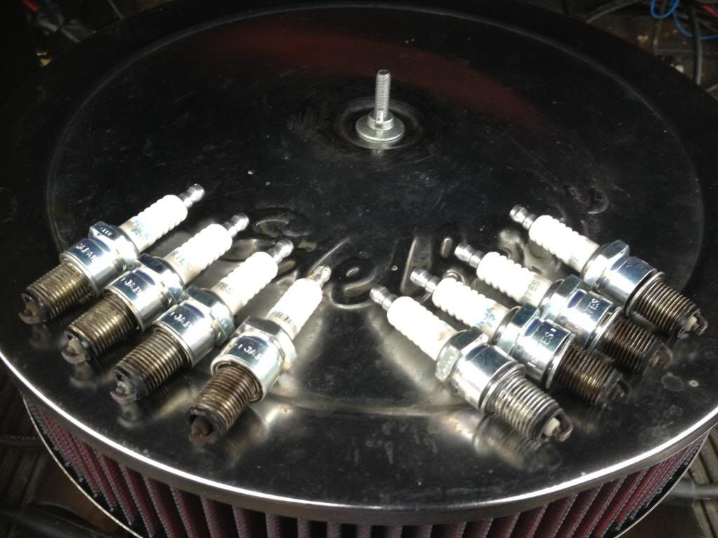

Anyway thanks for those pics!! Funny how its always the drivers side!! Plugs are quite inconsistent despit consistent pressure readings in all but 6. Here is a pic of the plugs, and the car to put it uni context.
