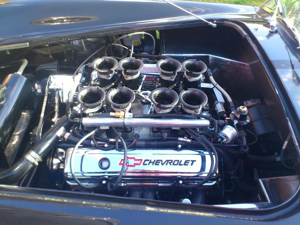

I gaineed approx 10% when I went from Rover 70mm plenum to Jenvey throttle bodies! They're now on my 383 Chevy engine
Big Tone
www.cobratone.co.uk
