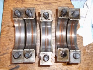

Keep an eye on your oil - all that fuel could be getting into the sump destroying your oil and subsequently your bearings.
That's what happened to these - out of a 440 big block that had been cranked to death with a flooding 4 barrel carb -
Stuball
Posts: 187
Joined: Fri Nov 17, 2006 11:46 pm
Location: Huntingdon, Cambs
Post by Stuball »
Cheers Eliot, will keep a close watch on it 8)
