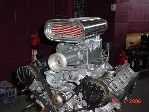

You can even buy off the shelf 'retro' looking blower installs
