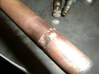

Tig can weld anything, ally, steel, stainless, copper - for fun i tigged a piece of 15mm waterpipe using a bit of twin and earth as filler:
