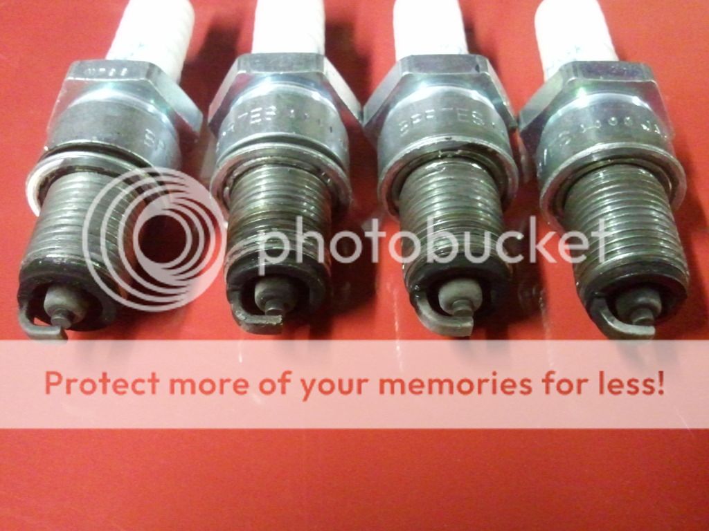

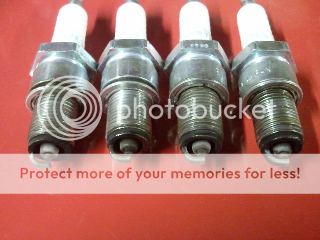

Photo's of my plugs I took last night:
7,5,3,1
8,6,4,2
What do you guys think?
Cleaned them with a wire brush, put them back in, ran fine for the first 6 miles, then started missing and 2 and 3 went down.

They don't look that bad to me but really it depends on what the engine was doing when you switched it off, if it was ticking over for a few minutes then they look OK, if you were doing a 'proper' plug chop then they look rich.
Really I think that plug reading is a waste of time anyway as unleaded does not change the colour of the plugs in the same way that the old leaded fuel used to. It will make the plugs go black if the AFR is miles too rich but reading the plugs won't get you very near the mark once you start getting close to what is required.
Here's a quote from Vizard..."Plug reading is less of a black art, it is more of a fallacy" :?
