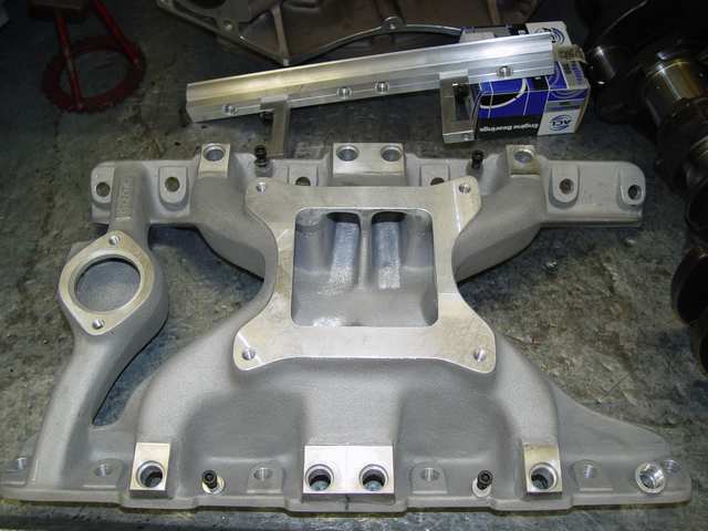

My gut feeling is the wildcat single plane with 4 barrel throttle body would be the best for max power in my application and would probably gain me 20 odd bhp
Any one want to throw there 2 pence in?

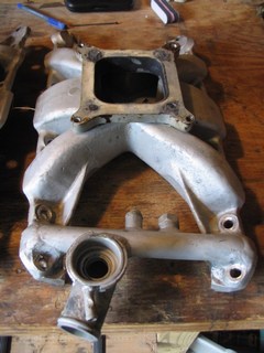

He's a few of my favourites
As above with injector bungs machined out
