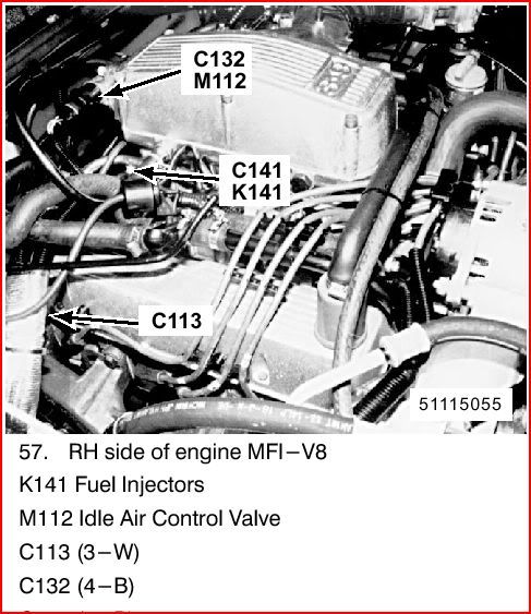

Even if you are registered on Google docs it returns the error documentt not available.DaveEFI wrote:That link requires you to register to view. Photobucket and others have a direct link facility to a single pic.
As for two sets of 5 blue wires bridged. Unless a previous owner has done a load of wring changes then thats not them
Will get a proper picture in the light tomorrow but this is a picture copied from the LR rave workshop manual. The conector on the RH bank is arrowed as C113 n this pic
Rob
