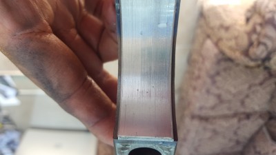

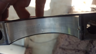

curiosity got the better of me, so I took out a main cap.
Not easy as they are tight fit between the sides of the block.
No gold showing.
One odd indentation from something once!

I'll say again. Even with knackered bearings you'd still have some pressure.

Didnt realise that's what the photo was....it's always best to leave it in the pleats where it has gathered than pour it all onto a rag. Let's you see all the pieces better so you can also test with a magnet etc. Plus get a good picture of overall quantity
Main bearing looks fine, but it will always be the rod bearings that suffer first.
Again...get the pump back together and spin it up with the drill.

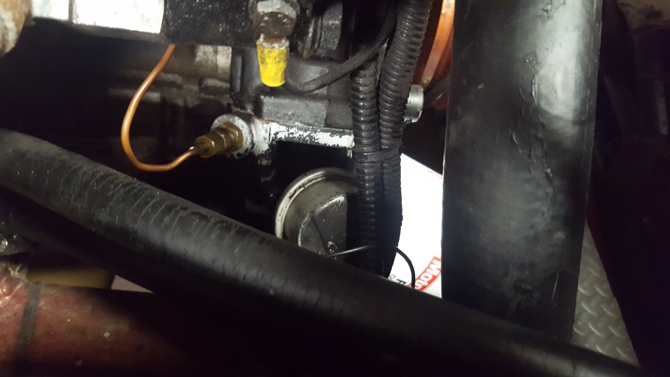

Looking at my oil pump there is a warning pressure switch and a gauge BUT they come off different places. The warning light goes nowhere as there isn't a light on the dash that I can see.
Is it possible that the gauge is reading pressure before the relief valve?

There's where the oil pump gauge and warning switch are plumbed in:

Going from memory I don't think it's possible for anything to measure pressure before the relief valve as the valve acts direclty on the pump area, it sits in the area where the pump gears are generating pressure.
Don't really know what you mean by an uprated pump, as far as I know where have only been two pumps (prior to the crank driven one used on non-distributor vehicles), the early one, up to P6 era and the later one which came in around the time of the SD1. The later one has longer gears giving greater capacity and hence flow but not (necessarily) any more pressure. I guess it's possible to upgrade the shorter style to the later version with a spacer plate and the later gears, but that's not something I've ever looked into as I dont' need to.
There are after-market upgrades available such as stronger spings (pretty sure I have one of these in mine).
It sounds like your pump may have always (during your ownership) been allowing some flow through the pressure relief valve hence dropping the pressure and just got worse or it may be that the different oil you have in now is allowing the downstream system to generate more pressure. Either way that can only be a positive thing IMHO.
Good news on the 'fix', lucky you caught it in time before the low pressure caused further issues. Always best to have a light as well as a gauge. I have a sad story about that!

Yes I think I have the SD1 era pump, fitted to a 4.6 so it can run a dizzy and carb.
It's odd that someone put on the pressure warning switch but no light. The Morris Minor speedo doesn't have an oil pressure light, but other Morris cars do. Anyway it will be a worthwhile mod to add one somewhere!
