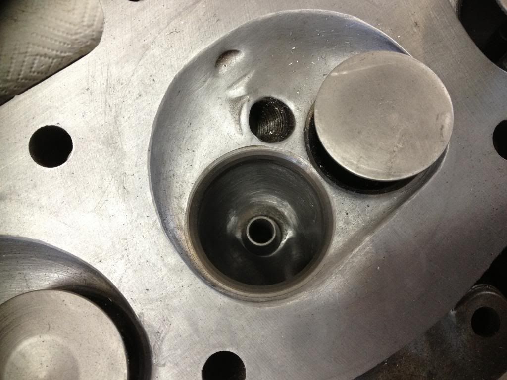

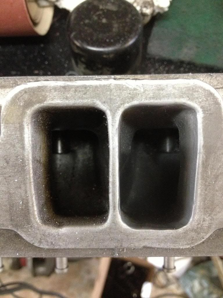

So started modestly extending the port roof to take away the existing divet and straightening - will then put a dot Annie weld in the floor and raise the floor a coresponding amout - only about 5-7mm Is. But should improve flows and mid range gas velocity. Will perhaps bench the heads before assembly??? My floating bench it ok for development - but I wonder if dark speed would help me out???? ... it will help me make a wiser choice of cam also.
DaviesDJ
Posts: 430
Joined: Sat Jun 09, 2012 5:03 pm
Location: Midlands
Post by DaviesDJ »
Have put 3 or 4 spot welds into the floor of the port (anchor welds) to fix the epoxy in well. Have also extended a mm or two since the last pics upwards and smoothed. Once epoxy in will blend the raised floor with the short side radius. Thinking about the bowls - these are all DIY by myself from last time, but thinking about the guide boss an throat- all blended well but should I "hog" it out any more??? (See pic). And am still thinking about the cam???
