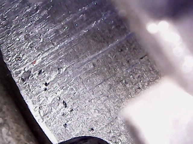

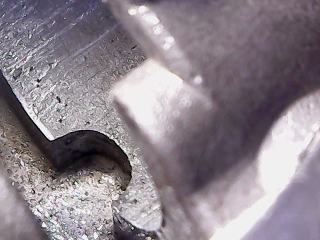

Yes the inside of the pump surface is rough as fruck...
I can tidy it up a little but if the clearance is over 6 thou (0.15mm) then the timing cover is toast I guess.
I might check the big ends and caps. I really want to free up the relief valve and see if I get any pressure with a drill on the pump though... TBH getting the sump off is easy on this car. There's loads of room and clearance.

Poor finish on the inside of the pump is less than ideal and may lose some pressure but unlikely to drop pressure completely or suddenly. What would worry me more is that this most likely indicates that the engine has had poor quality and/or contaminated oil in it at least at some point in its life,
I seem to recall fitting a different pressure relief valve to my pump which was spherical in shape (a tadpole rather than a slug) which is less likely to bind up in the hole. Also fitted a higher pressure spring, not really necessary but does give peace of mind.
Personally I think I'd get that valve running properly in the bore put it back together (packed with Vaseline) and spin the pump over with a drill before I'd start tearing the engine apart. This is one of the "usual suspects" which would give exactly the symptoms described, sudden and complete loss or pressure so would make sense to check first.

Pretty well all the RV8s I've stripped have scoring in the pump housing and end. How much it affects the performance, I've no idea. But doesn't stop them delivering at least some pressure.
As regards the priming thing, I take the plugs out and spin it on the starter till I see oil pressure (after filling with Vaseline, obviously). I reckon that less work that having to set the ignition timing again. And that makes sure oil is on all the bearing surfaces, before starting. I'm not convinced the drill method will do much more than fill the oil passages. Oh - I do have a drill adaptor, so I have the choice.

Just checked clearance on the oil pump and despite looking rough I couldn't get a 4 thou feeler in there. 3 went in just. So not as bad as I had feared. Its 2 thou new I think.
Going to make a drill drive so I can spin it up, after packing with vaseline of course :D and see if I get any pressure.
