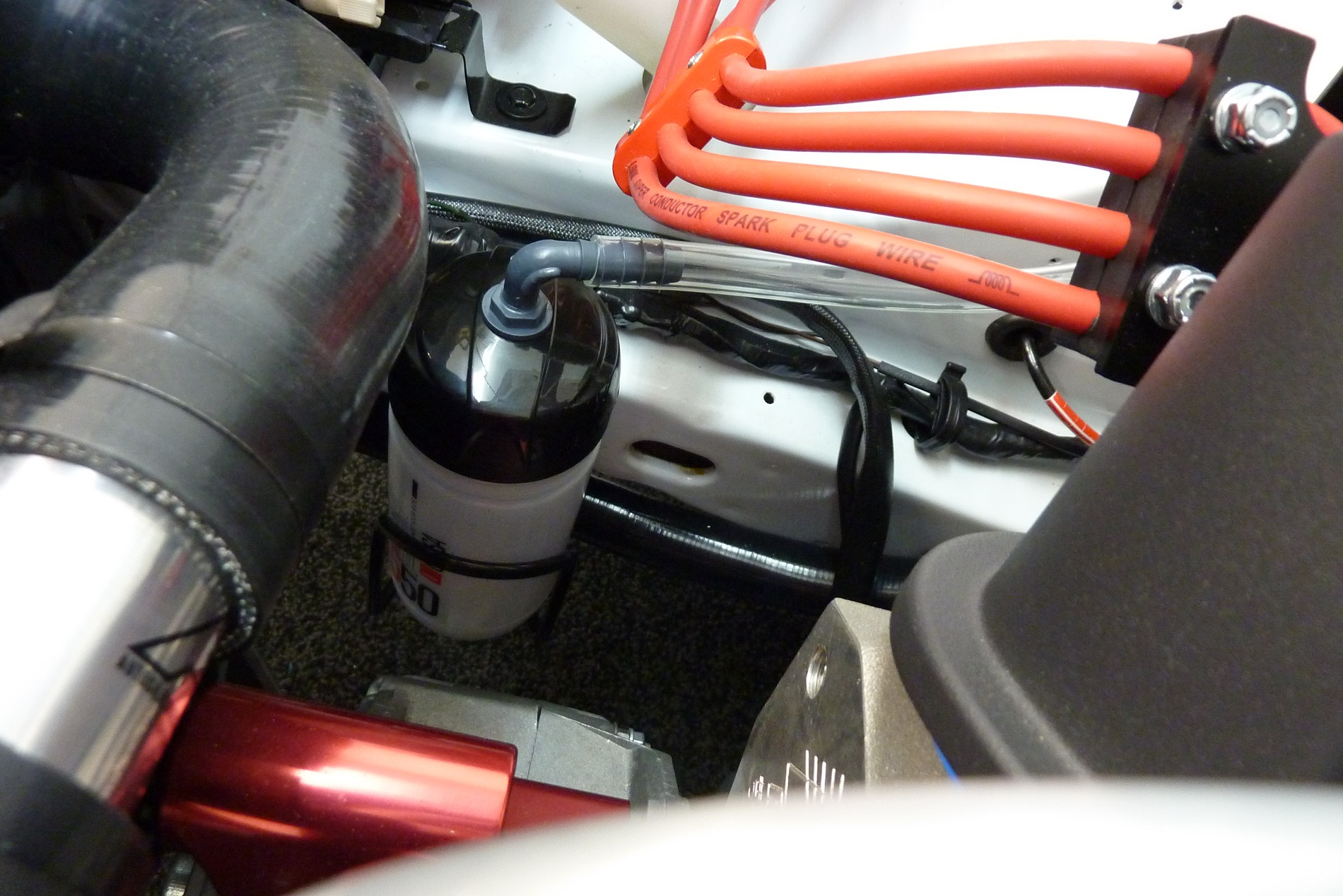

Water tank, breather tank, breather pipe, custom rad etc
Halfords pushbike water bottle catch can...

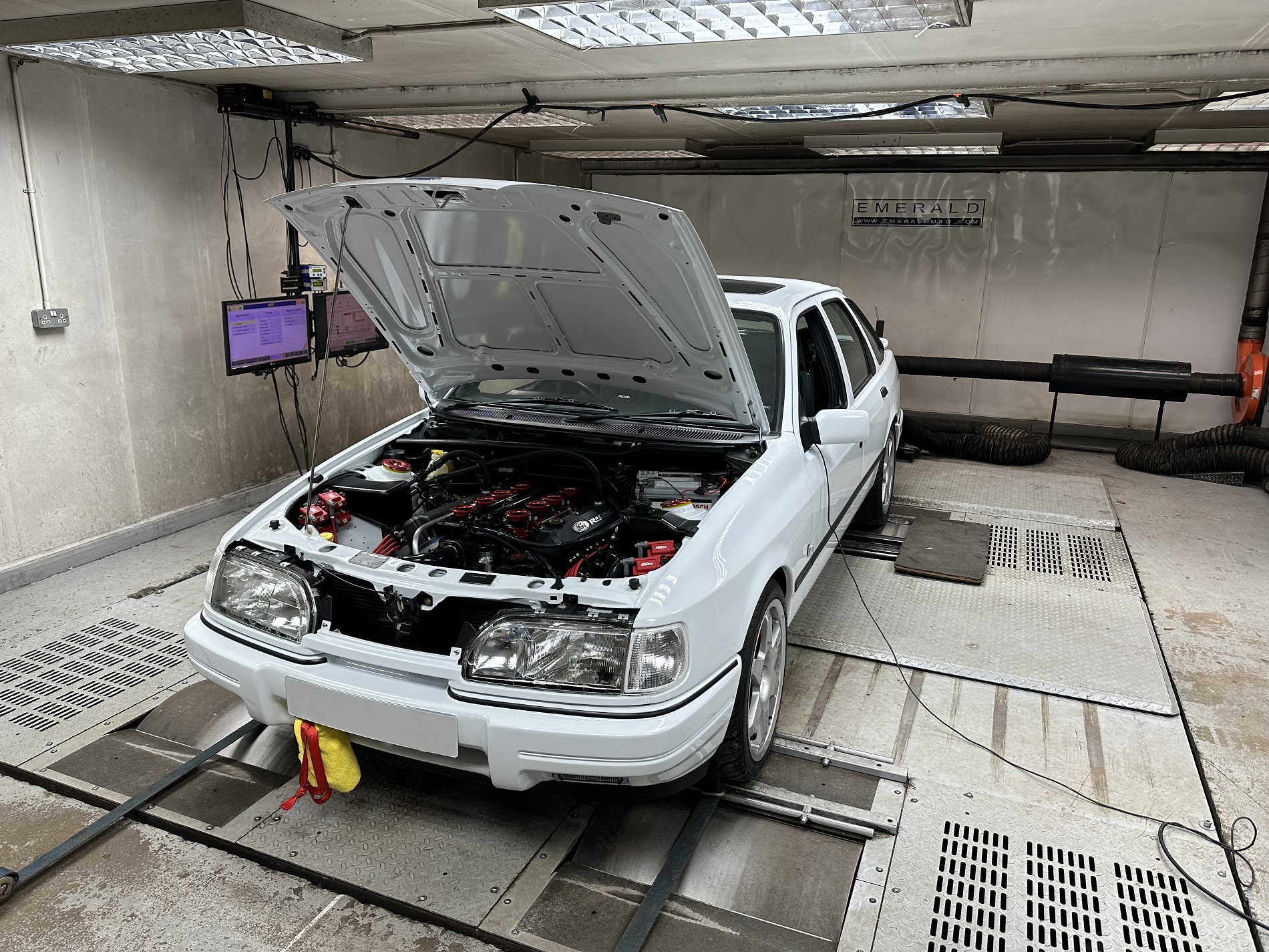

It's trying my patience, the Jag diff keeps spewing oil out of the breather on the diff cover I made and I've been trying to fix it since January :(
Had it trailered to Emerald for mapping and only got to 1/3rd throttle mapping and it made a right mess ending the day!

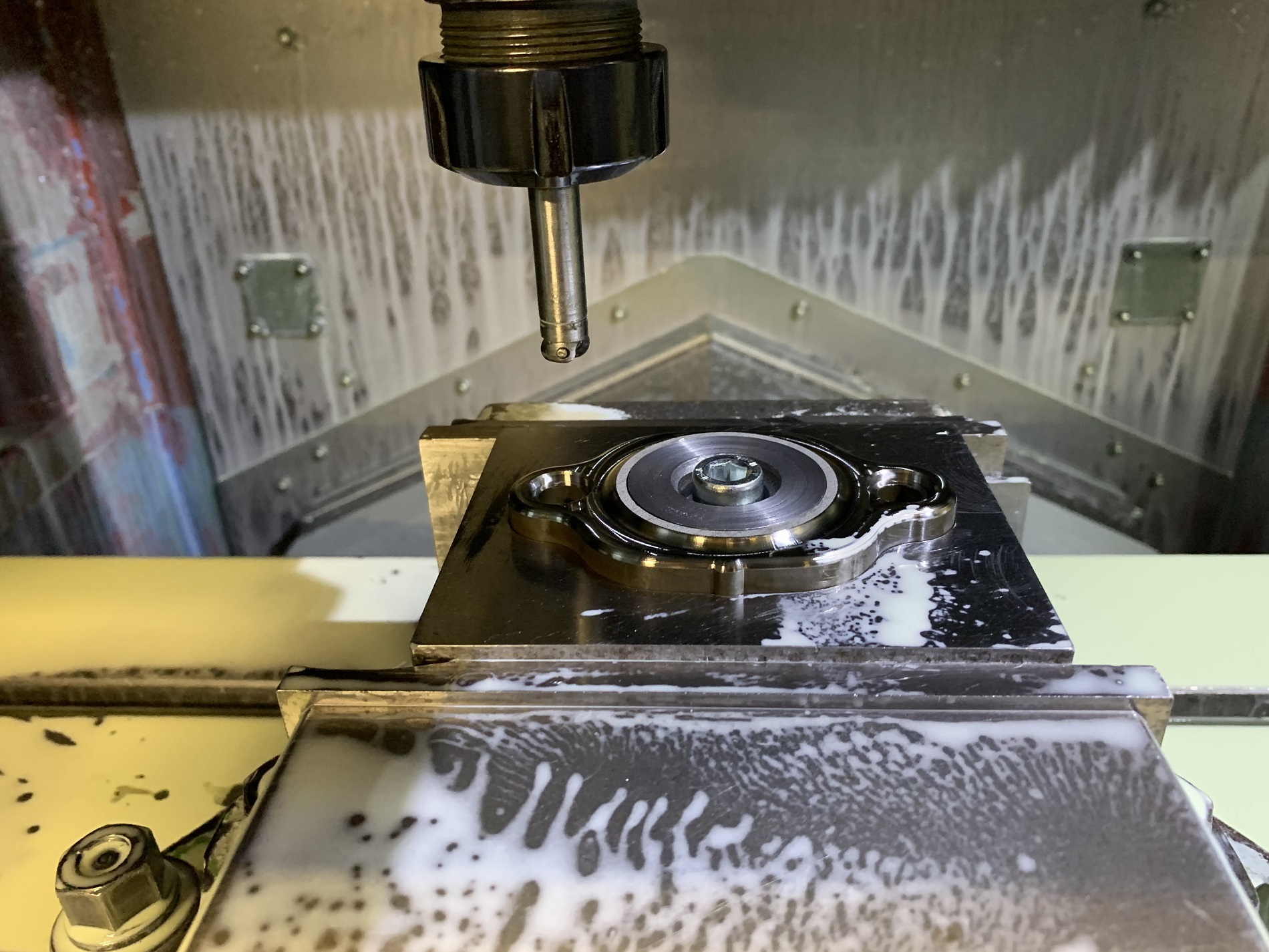

After struggling with making headers for the last engine I cheated and had the whole system made by a lad local to me who is much better at this sort of thing, all I did was make the flanges to match my cylinder heads at work.
