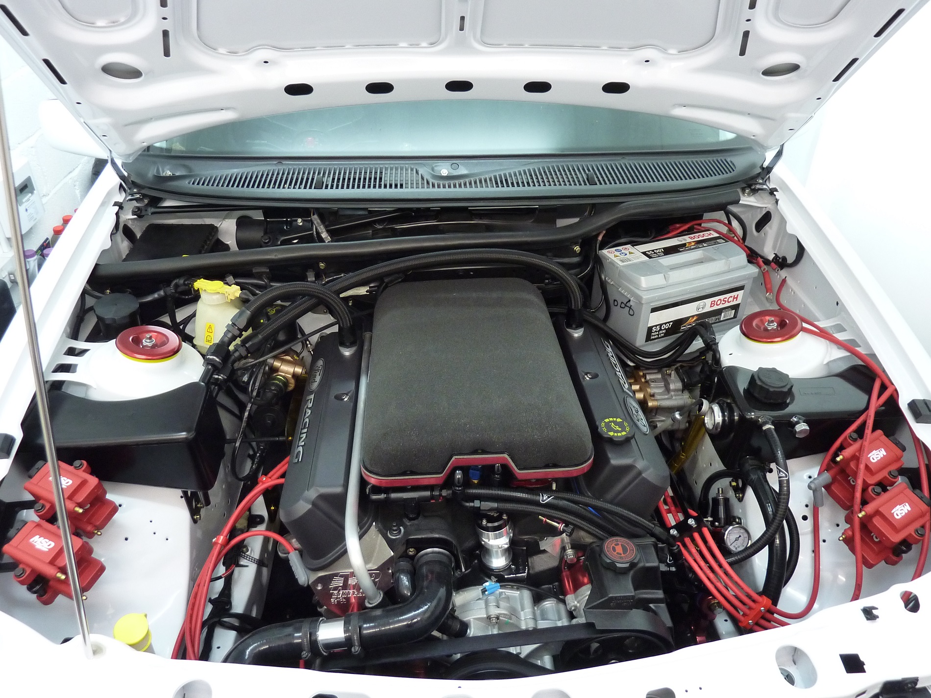

This bit took three days of pissing about to get it to fit right
Must have had the engine in and out at least ten times making adjustments here and there.

Made up a throttle linkage to take left hand drive Cosworth cable.
Re: My V8 Sierra project ..... maybe I will finish this one !
Water tank, breather tank, breather pipe, custom rad etc
Halfords pushbike water bottle catch can...

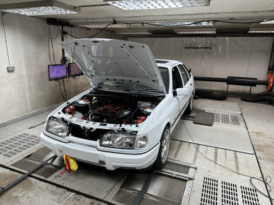

It's trying my patience, the Jag diff keeps spewing oil out of the breather on the diff cover I made and I've been trying to fix it since January
Had it trailered to Emerald for mapping and only got to 1/3rd throttle mapping and it made a right mess ending the day!
