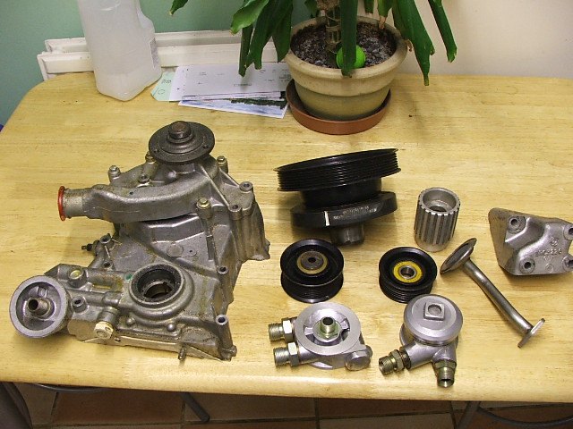

Timing cover is now here
defo a few bits missing,
we have a bracket with part number: ERC 3226
it has a british leyland emblem on it above this part number,
anyone a clue? its an alternator bracket looking at it,
it will be going back on ebay as not needed, but need to know myself what its from first
will post pics up later of the bits we got,
This is the bracket we aint sure about :
would like some pics of engines with this set up on so i know whats missing please,
so far have worked out thats missing:
the water pump pulley,
tensioner and pulley,
idler pulley????,

i think we have a complete serp front end now
The alternator bracket arrived he weekend from Rangerover heaven,
will post the bracket part number up ASAP to help anyone else out, (its for a non air con model)
100 amp alternator from ebay arrived today,
along with the belt tensioner and waterpump pulley from member Slatter, (edited cos i cocked up
hoping to do a dummy mock up over the weekend on a spare v8 engine at caprisport,
will take some pics and post them up once together,
fingers crossed its complete now minus a few nuts bolts etc.

Here we go:
100amp alternator.
Alternator and belt tensioner,
Think Its complete now:
Alternator Bracket Number ERR 4291.
Please Note: this is a non aircon bracket,
Powersteering Bracket Number: ERR 4053
Crank Pulley Number: ERR4866
Powersteering Pulley Number ERR 4868
Water Pump Pulley Number: ERR.... (not got this number yet, only the number shown on pulley)

Right,
ignore the above part number for the alternator bracket,
as its a 4.6 serp one not 3.9,
so im either going to have to make a 50mm approx spacer to move the alternator into its correct position,
or try and hunt down the correct bracket from a discovery / tvr gutted
