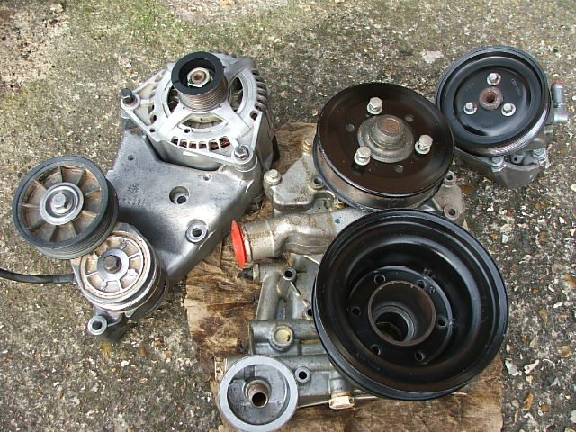

have now got (ebay) a brand new 3.9 interim serp timing cover with front pulley water pump etc,
http://cgi.ebay.co.uk/ws/eBayISAPI.dll? ... NA:GB:1123
are the alternator brackets and power steering brackets the same for both style of serp fronts?

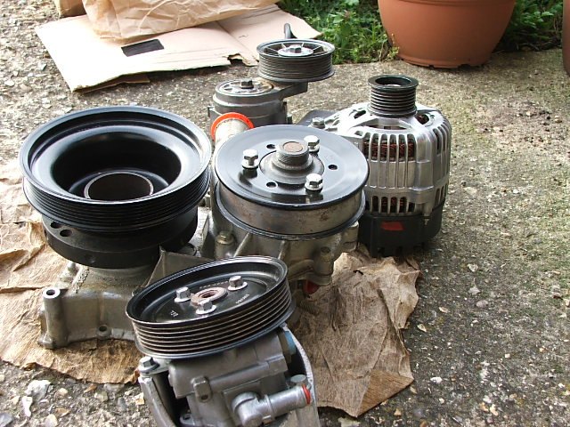

im missing alternator bracket, power steering bracket, alternator. power steering pump is sorted thanks to Gav, and waterpump pulley and possibly a tensioner is sorted by slater, (maximmotorsport on here i think),

That's the same front end config I have on the Griff engine. If you need any pics regarding triggers or how it fits together then let me know.
yes please mate,
as i aint a clue how she goes together :lol:
i gather no one knows if the parts are the same then :cry:
although 51 views :cry: :lol: :cry: :lol:

been informed, that the 4.6 brackets are 50mm shorter than the 3.9 interim ones,
so does anyone know where i can get the brackets from plz???

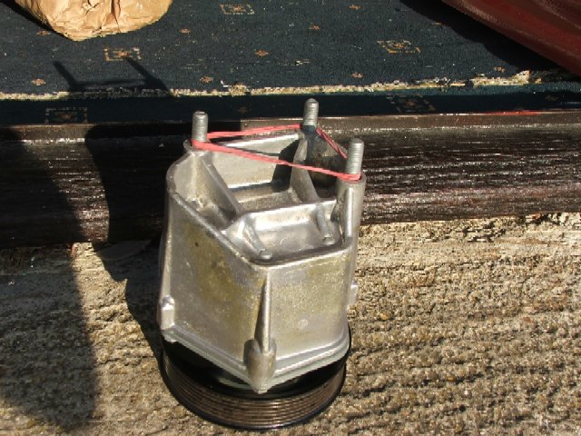

I think John Eales sells an alternator bracket for the intermediate setup.
Not sure of price though :shock:
And yes it is different to the GEMS version. On a GEMS the alternator sits quite high I think which is why I can't go that way in my Westfield.

I have both style front covers, and every type of bracket.
I could not get any of them to fit with enough clearance, so in the end welded up my own in steal.
triggerwheels.com do a kit for the int. pulley, Also I've fitted one to the latest style front end. (I'm currently the only person I know who has done this)
depending where you are you could come down and try all the brackets to see what one fits.

i have been told the interim brackets are longer than the gems one due to the dizzy hole,
if they are no use to you would you be interested in selling some of the brackets mate????

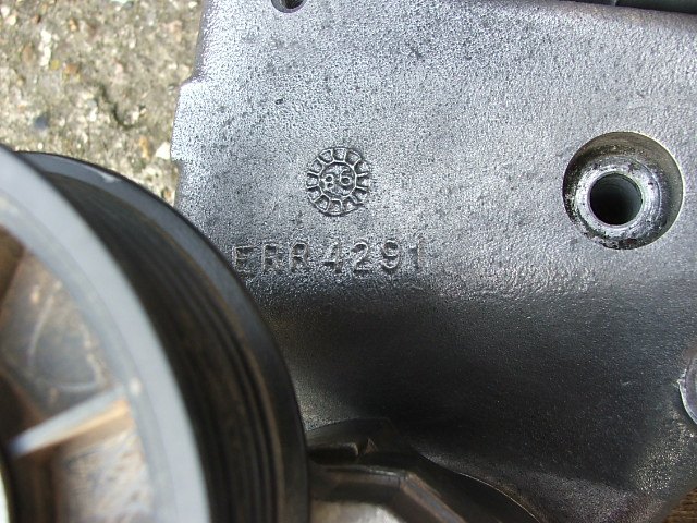

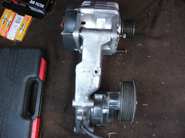

does anyone know the part numbers for the alternator and power steering brackets i need then?

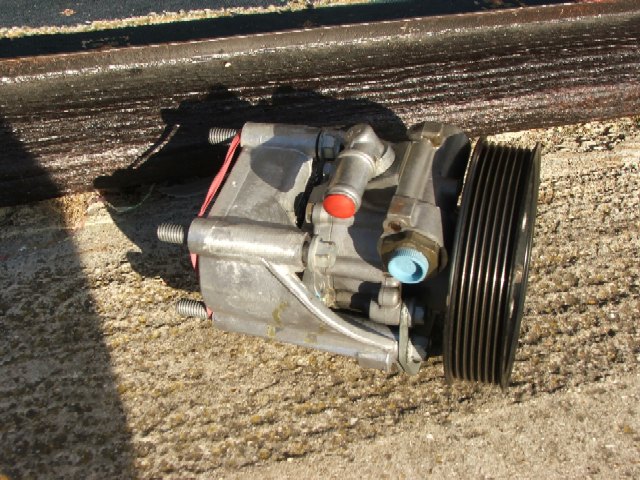

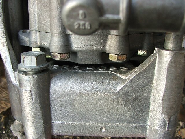

TVR serp powersteering pump and bracket arrived today from ebay,
bracket part number if anyone is in the same boat as me is:
ERR 4053
just need the matching alternator bracket now,.
