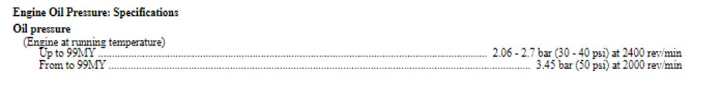

Just found this oil pressure spec in the workshop manual for pre 99 (GEMS) and post 99 (Thor) engines.
How does your oil pressure compare?
Interesting the Thor has a higher pressure - at a lower rpm. Checked early and later service manuals and both quote a 60mm pressure relief spring length! so I wonder how else they are controlling the oil pressures?

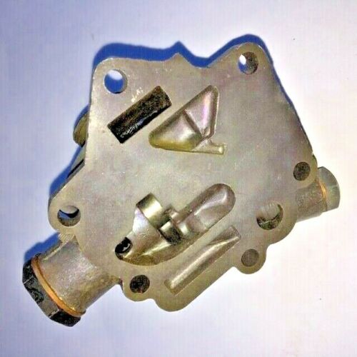

Hi, I'm new to this Forum and indeed new to V8s .
I have a Hawk with a Rover Vitesse V8 installed and today suffered the sticking OPRV!
So I'm here for some help.
The pressure went to the stop on the gauge - 100psi.
I took the screwed cap & spring out of the oil filter/oil pump housing but the valve is stuck in there.
No amount of pulling with a magnet or a hooked tool would remove the valve.
I'm hoping that once it's out I can just polish it with a bit of wet & dry.
Any ideas??
Thanks in advance.
Phil.

phlize
Posts: 3
Joined: Wed Oct 05, 2022 8:45 pm
Re: High Oil Pressure
Post by phlize »
Any ideas on how to remove the plunger valve??
Phil.

phlize wrote: Wed Oct 05, 2022 10:50 pm Any ideas on how to remove the plunger valve??
Phil.
Depends how badly stuck.
make up a blind puller ( or buy one ), heat
Can you not just tap it down with something suitable ? It's pretty easy to see. Heating the housing might make it move a little easier.
I think the problem is that it's in a blind hole, so you can't push it from behind?
Maybe a grease gun on the port that connects to the back of it, and try to pump it out?
Posts: 4112
the plunger is plain to see in the picture. Yes you might not be able to touch the end you likely do not need to.
And it is easy to get a blind puller or make something up to pull it out.

Compressed air is the best bet, it won't take all that much with no spring behind it. How have you got it stuck closed? Never had that, they always stick open IME.

Post by phlize »
I tried turning the engine over with the coil disconnected but it didn't move.
I was trying to avoid taking it off the engine but working upside down in a confined space limited what I could do.
So in the end I admitted defeat and unbolted it from the engine.
On the bench compressed air didn't move it - the air just escaped from one of the drillings.
I managed to extract it using a piece of wooden dowel rammed in the cavity in the bottom of the plunger.
Eased the bore with some wet & dry - the plunger was unmarked - to the point where it moved relatively easily.
Now back in the engine & oil pressure 40psi cold - fingers crossed it doesn't go much higher on the road test tomorrow.
Thanks for all the suggestions guys,
Phil.
Posts: 4112
It's the only correct thing to have done.
How tight did it feel in the bore ? must have been pretty tight to get stuck like that ? Was the bore itself smooth ?
