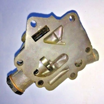

Interesting the Thor has a higher pressure - at a lower rpm. Checked early and later service manuals and both quote a 60mm pressure relief spring length! so I wonder how else they are controlling the oil pressures?
