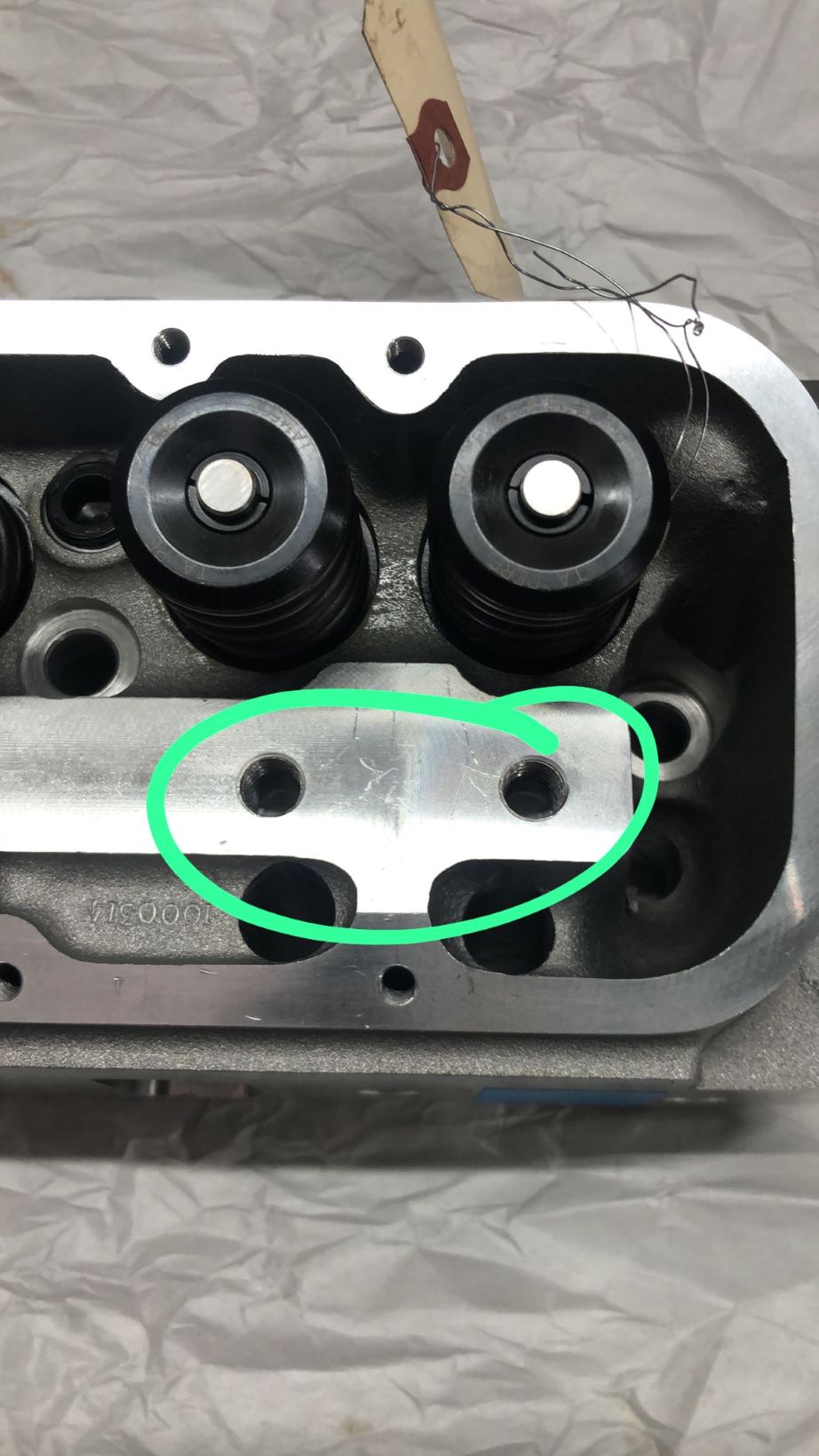

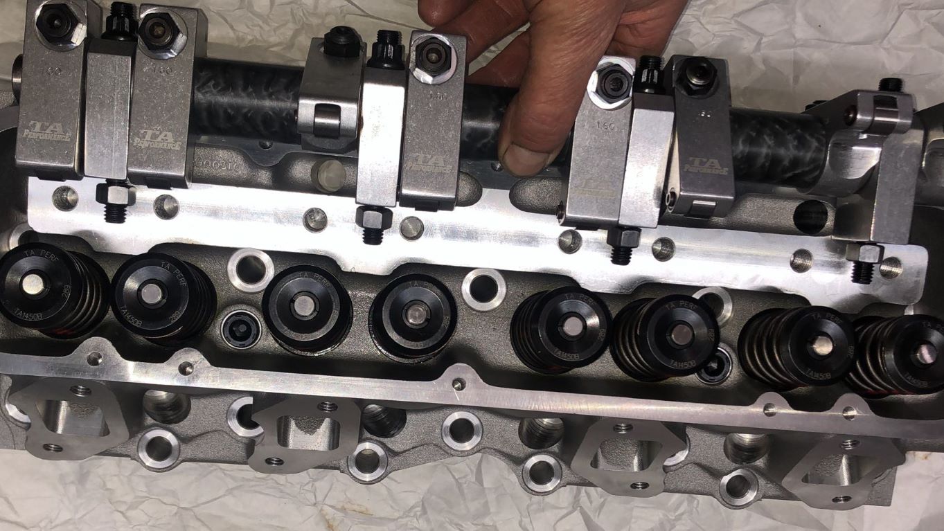

3. We know that the RRs they sent are not correct (so I am chasing to get these replaced, see pictures)
4. It says that you can use solid or hollow pushrods, but dimentionally, it looks like we can only fit hollow rods. Is this correct?

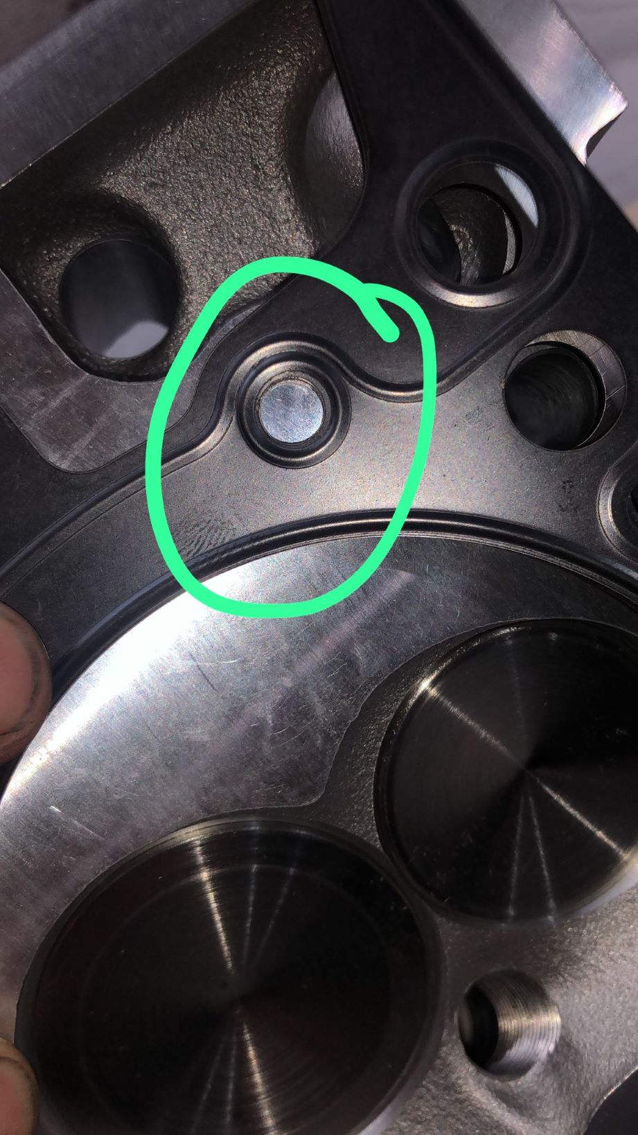

5. The oil way looks to be closed (see attached photo), was your assemblies the same, and did you leave them (relying on hollow rods) or did you machine that open?

For the oilways - check on the block as there is only one, at the front of the engine if I remember correctly. But the head gaskets have two holes so you can use them on either side. Not sure if that relates to the missing holes on the head or not!

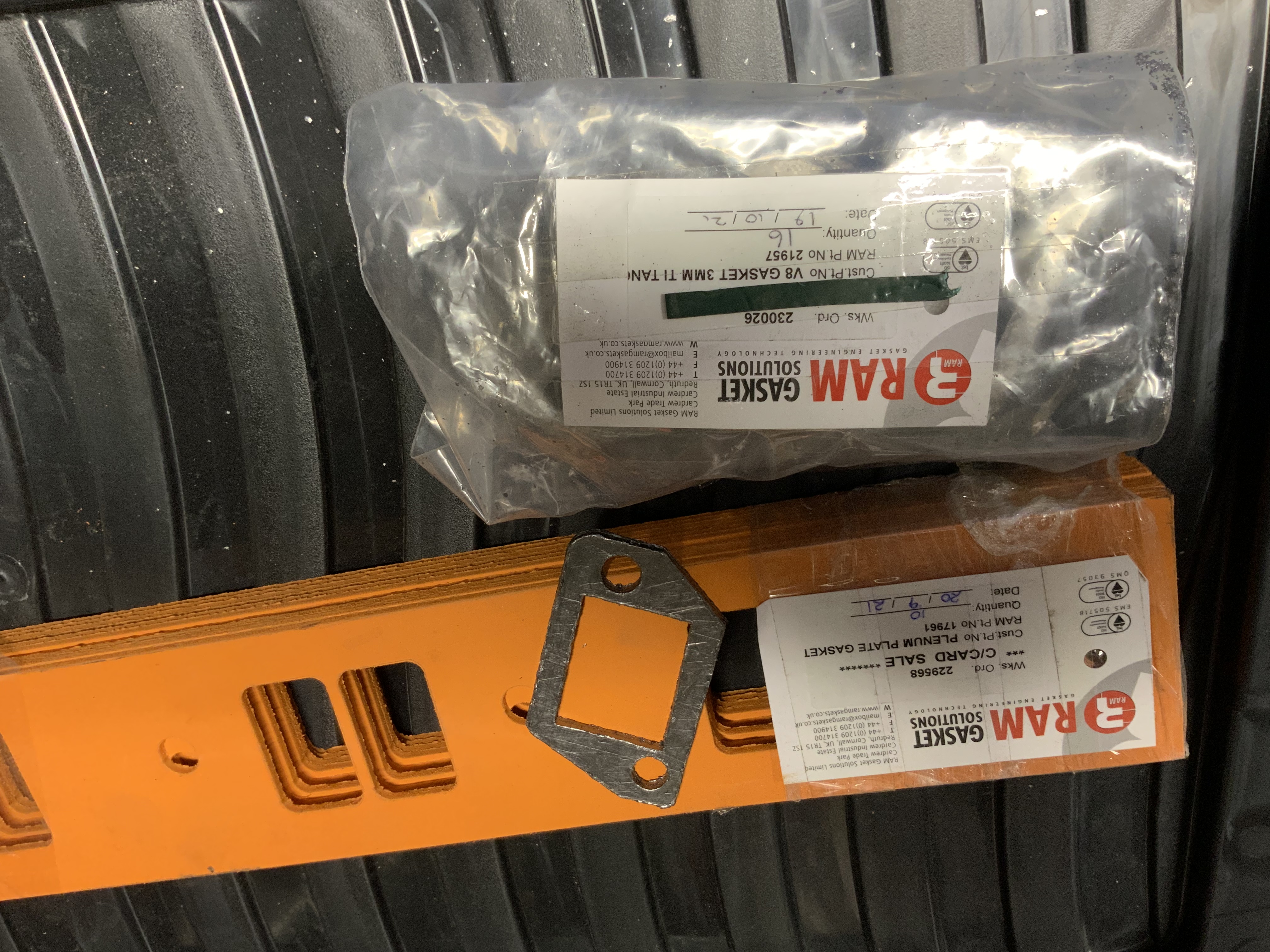

Pic of gaskets I use, with part numbers,
Please note, inlet gaskets come in different thicknesses,
Really helpful,just ring them up, and talk to them

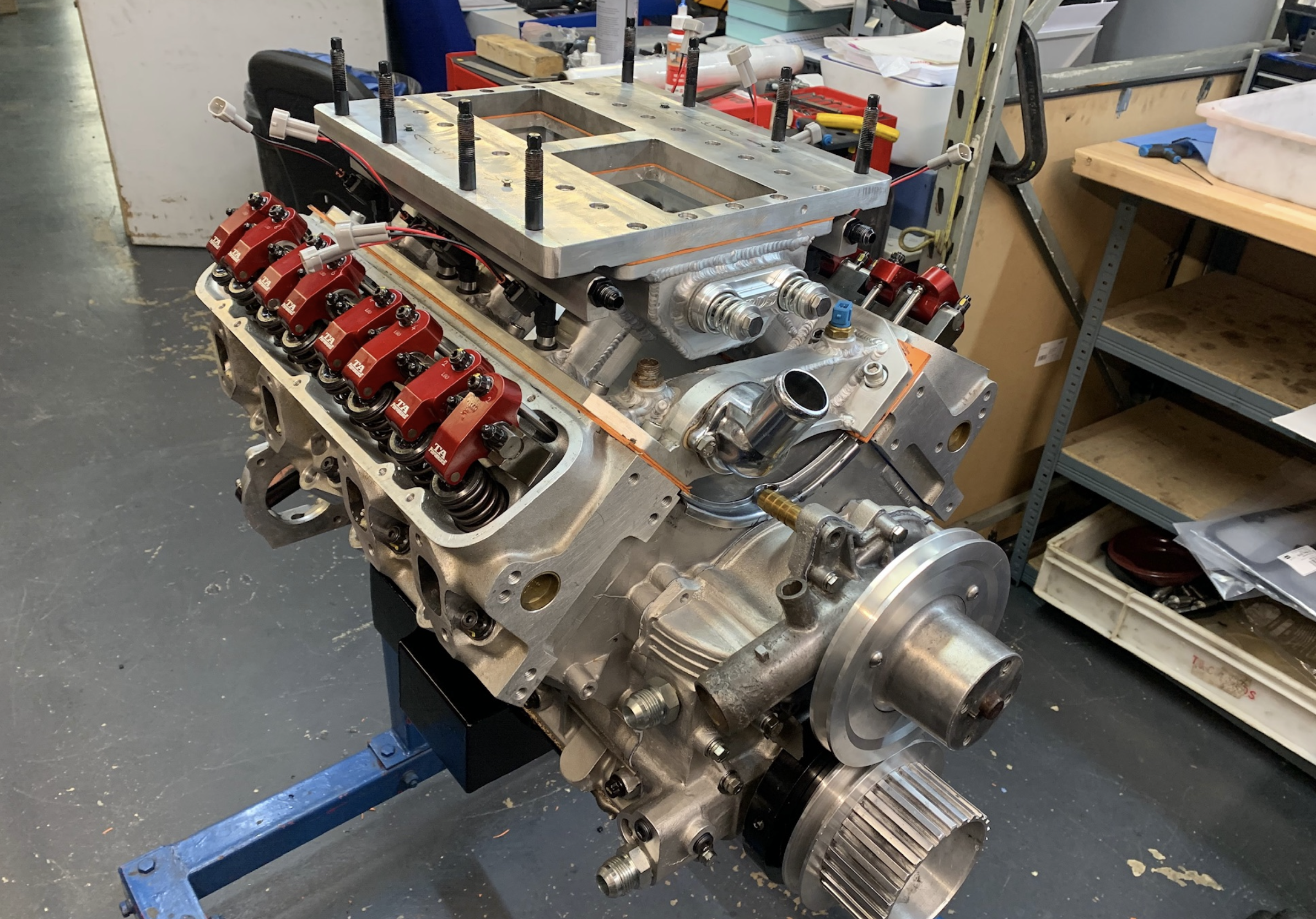

Well, it's been a long long time, but just thought I post on my work with the TA heads.
The journey has been long, a bit of a challenge and expensive, but we have a working engine and happy to relay the delta in heads on a real world test.
This is a race engine for a race car, so please take that into context.
Same car, same tramsmission, same diff, same wheels and tyres.
The build with the TA heads is +85bhp and +77lbs/ft on what a 5ltr with Stage 3/4 CNC heads (V8D, JE anyone else that supplies etc etc), jenvey 50s downdraft and a 256 cam.
That is a straight comparison on the same dyno. I can be confident of the outcome as I have both engines, so I am comparing 1 v the other in the same car.
What have we learned?
The heads are great. Good product and very well cast and machined. Anything under 5ltrs or unblown its not worth it in my opinion. At or over that and its game on. An aggressive roller cam set up is needed. I am running a 256 and it really does want to go 7,000rpm+ on the dyno data, so a roller cam with a big profile will help and will also help get to that upper end safely. The dyno curve is 'beautiful', with no dips or odd peaks. That compares to the Stge 3/4 hears which have a 'dip and lift' around the 3.5k mark.
There is no doubt that buying a crate LSx would have been much much cheaper, but this was a bit of a Rover engineering exercise for me also, so despite the challenges, I enjoyed the process.
Oh..... and be confident in your engine builder..... that is another valuable lesson I learned along the way.
Good luck!
Martin.
