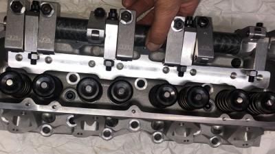

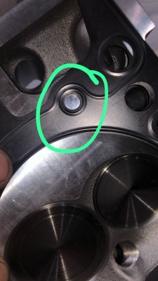

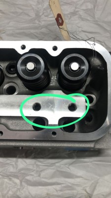

Morning all,
I am after a bit of advice with your experinces with the TA heads for the RV8.
I set arrived in the UK for me after a long wait)). We are slow build on the engine - as these heads are new to me, so please forgive my questions if they seem silly (and pictures not in order of questions...!);
1. Who would you recommend for porting and finishing? They need done as TA don't have a porter
2. What did you use for intake and valley gaskets?
3. We know that the RRs they sent are not correct (so I am chasing to get these replaced, see pictures)
4. It says that you can use solid or hollow pushrods, but dimentionally, it looks like we can only fit hollow rods. Is this correct?
5. The oil way looks to be closed (see attached photo), was your assemblies the same, and did you leave them (relying on hollow rods) or did you machine that open?
6. Anything else important you you think is worth knowing?
Thank in advance

Re: TA / Wildcat heads
You can use “cut” down rover inlet gaskets, and standard rover/TVR exhaust gaskets
Mine have been extensively ported, rover won’t fit, so I have my inlet and exhaust gaskets made by
Ram gasket solutions, I used hollow pushrods, I bought my heads from TRS in Australia,
For the oilways - check on the block as there is only one, at the front of the engine if I remember correctly. But the head gaskets have two holes so you can use them on either side. Not sure if that relates to the missing holes on the head or not!
