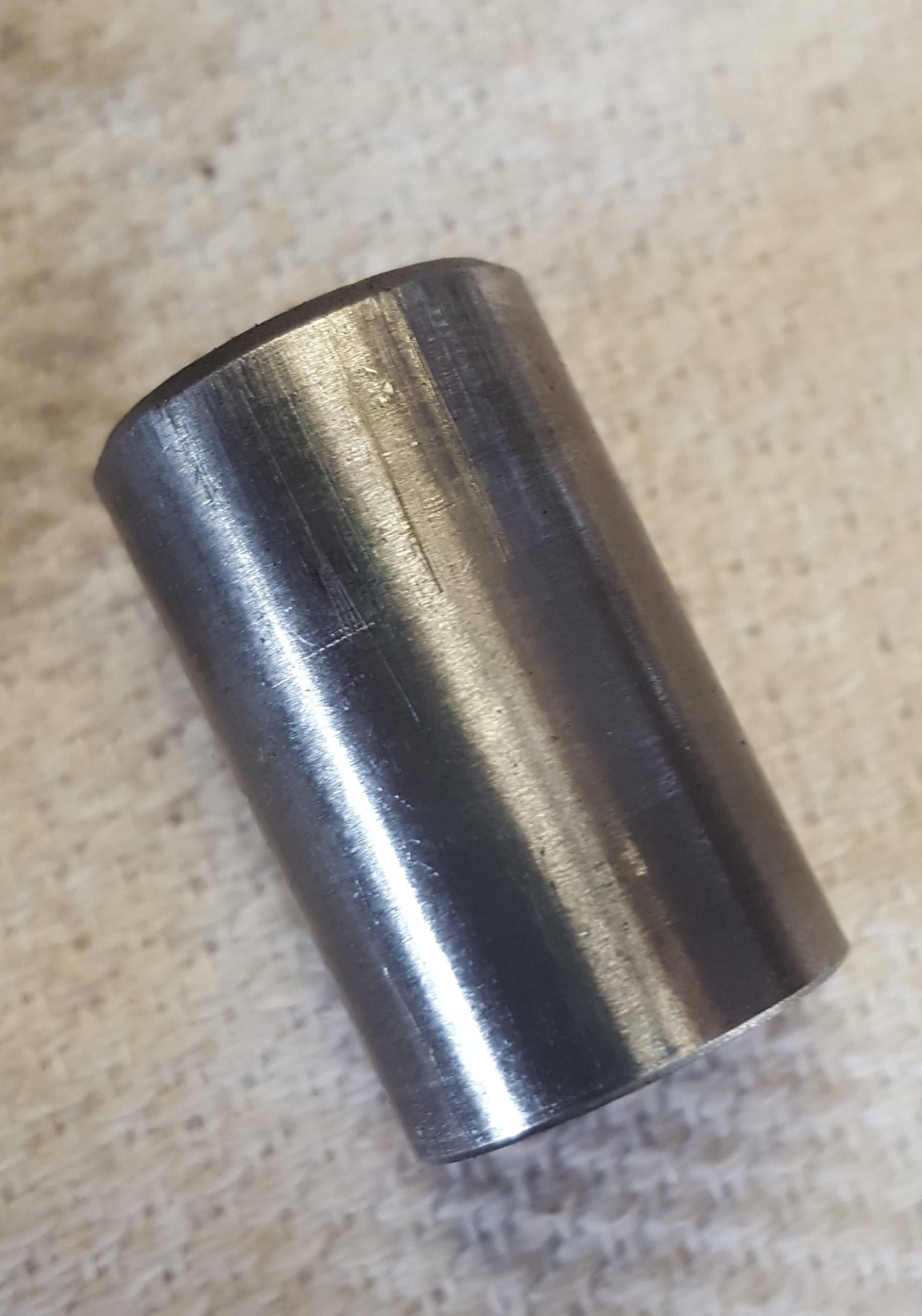

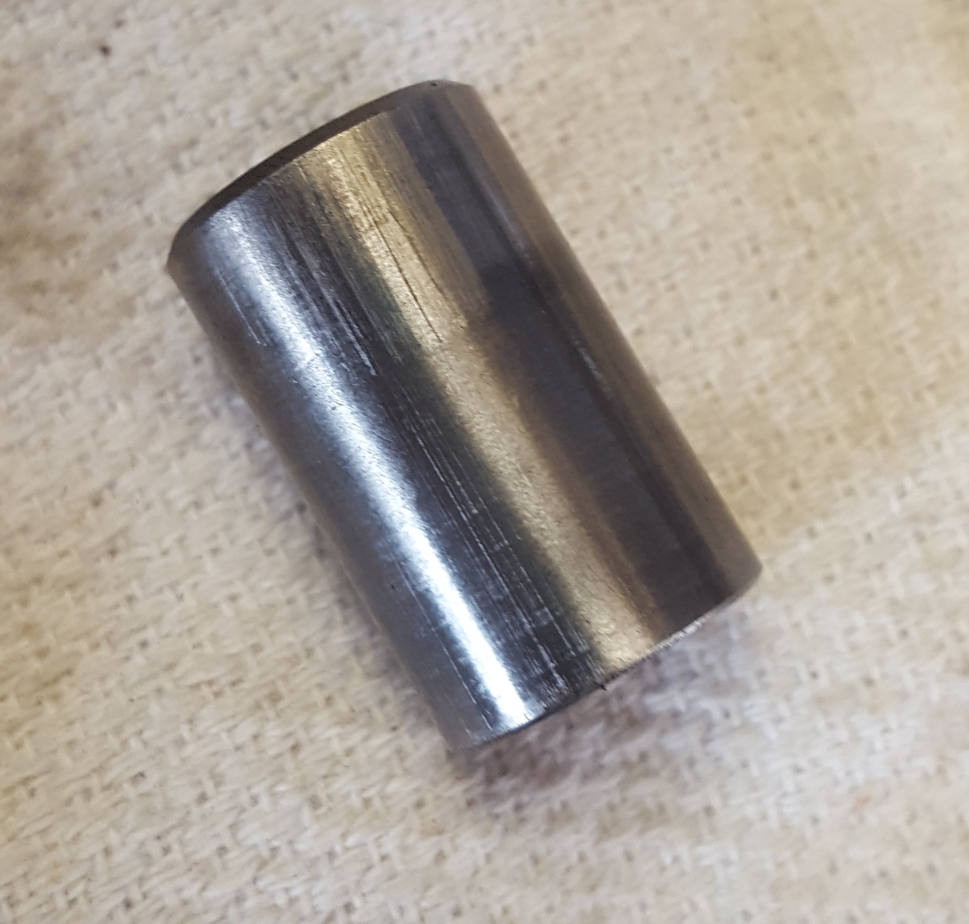

Here's the piston from the pressure relief valve.
Wasn't jammed in, but didn't just fall out either.

The fact you say it was tight in the bore is a red flag.
It would only need to be unseated a very small amount to allow oil to bypass.
So either hone the bore out, clean thoroughly etc and re-fit. And/or also fine emery on the piston itself to ensure a totally smooth and unhindered travel into the bore and down to its seat.
Bit of wet/dry should be fine for either. But it must be totally smooth and free.
Then put it back together, pump packed with vaseline etc, and remove the dizzy and prime the pump with a drill until you get oil pressure. I'd be loathe to turn the engine on the starter to try and get oil pressure as those old RV8 pumps can be a nightmare for priming.

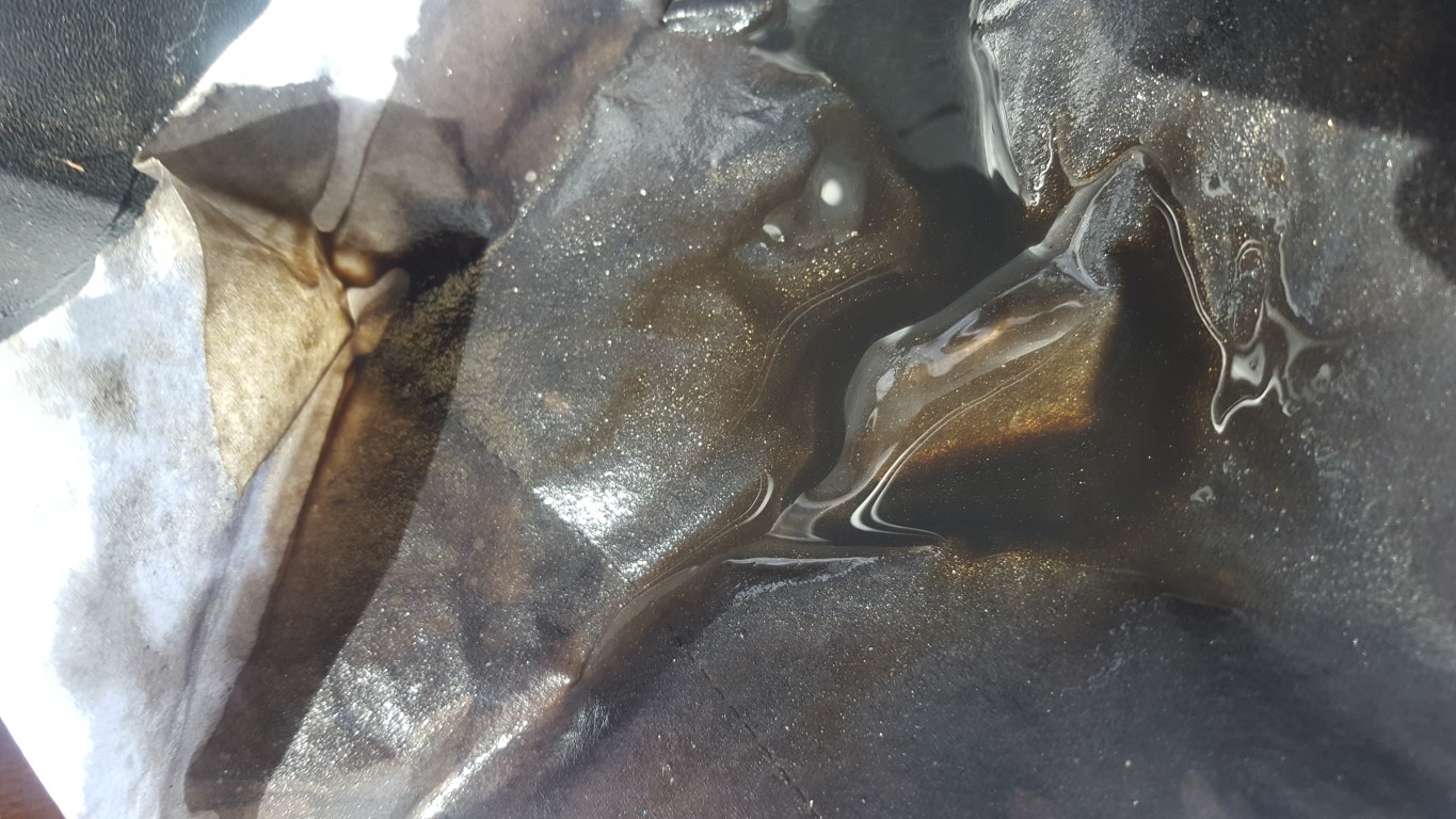

This isn't look too good...
This is from the oil filter, which I have just cut open.
No chunks or flakes but defo a very fine gold glitter.

And roll the paper out from the filter to see what has been caught in the filter pleats.

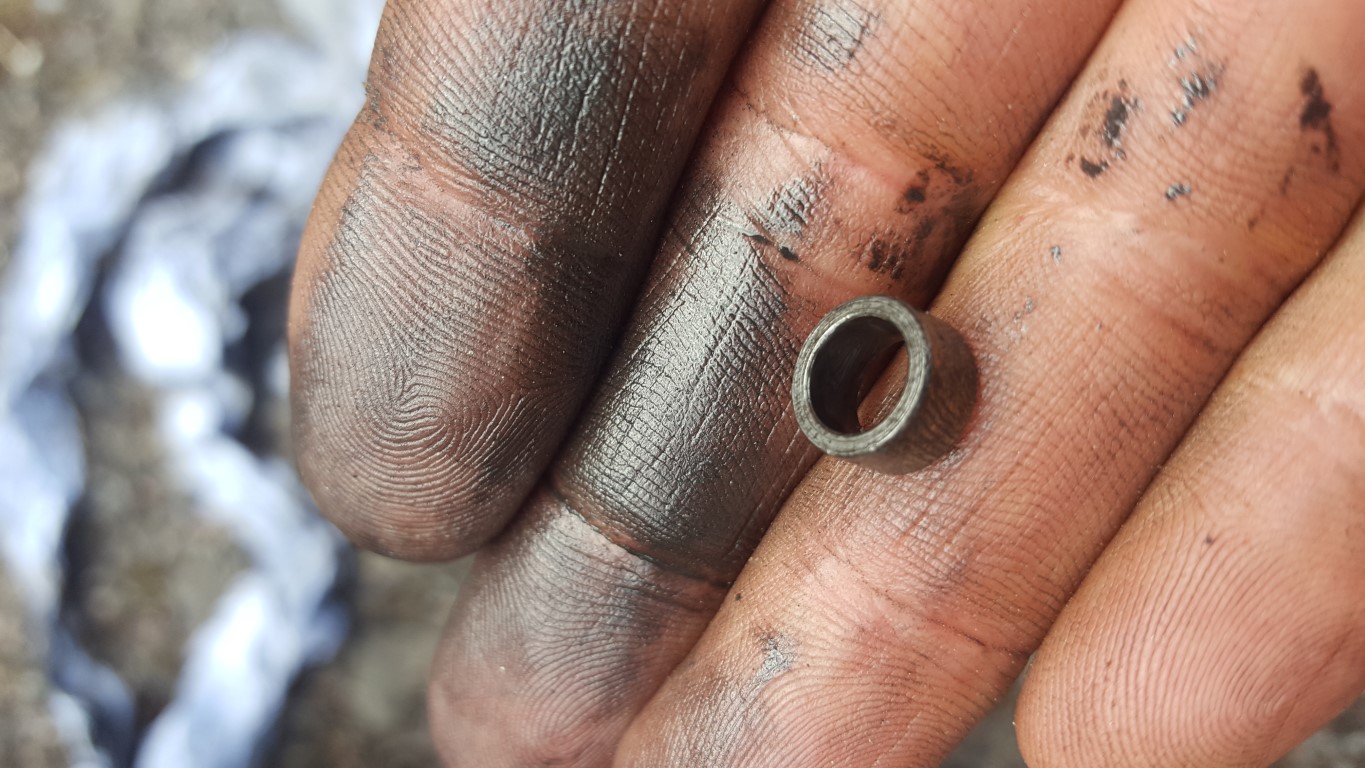

Also found a metal collar, possibly off a rocker cover gasket?
Not sure where to go next.
