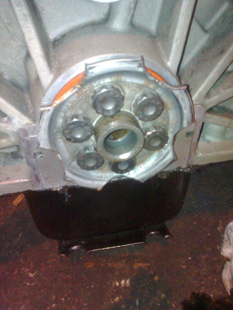

And cap heads! Hoping I wont get trouble with the flex plate, seen several results on Google of them breaking, do you think its more high mileage or high power (torque or revs) that kills them?
TC
It is high mileage/old age then hitting them with high revs, basically they work harden get surface cracks and then you seriously stress them and bang.
