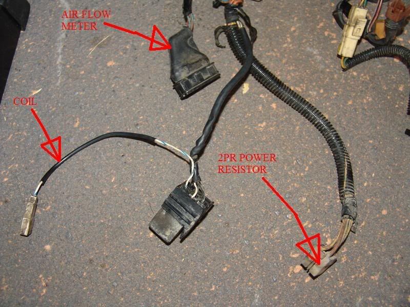

Here is a photo of what is maybe the black/white wire you speak of that goes to negative side of coil? This one is blue/white but it is right next to air flow meter loom? Any ideas?

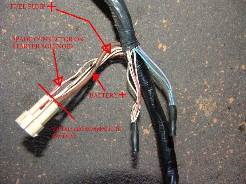

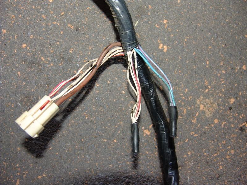

This is a photo of the only plug that i don't have a connection to on my truck or with the EFI bits that i have, i am assuming it contains the brown to battery +, the white red for crank side of ignition and white for ignition run position, an maybe even the purple/white for fuel pump? Am i close? Also, what are these two bundles that have been capped off?

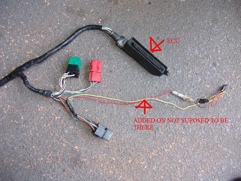

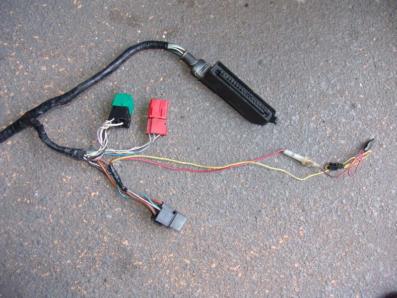

This is the end of the loom with the ECU connection and some relays, i am guessing that this red and yellow wire was installed by the last owner as it looks spliced into the thick brown wire? Should i take it off, do i connect anything there?
Thanks for any info, i just want to do this right the first time.

Awesome diagram, thanks for the info. What about the black/white wire that is supposed to go to the negative side of the coil? Which one is that?

oh but it looks like your missing the little resistor
its a black box with a spade connector at either end as its got a female connector on the coil and thats what it looks like you have on the blue/white
