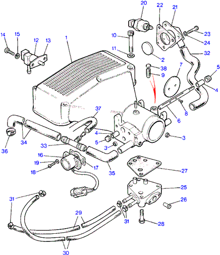

Still busy dismantling and cleaning parts in preparation for reassembly. I've completely stripped down and cleaned the plenum chamber and have a question about the small aluminium plate fixed to the underside of the plenum throat by four bolts. It has two metal tubes, presumably for rubber pipes and appeared to have a diaphram of some sort within it (which was damaged during strip down). What is this curious plate and what is its purpose?

The curious assembly underneath the butterfly is a small water jacket. It's fed from a small outlet on top of the inlet manifold, and I can't recall where the other pipe goes.

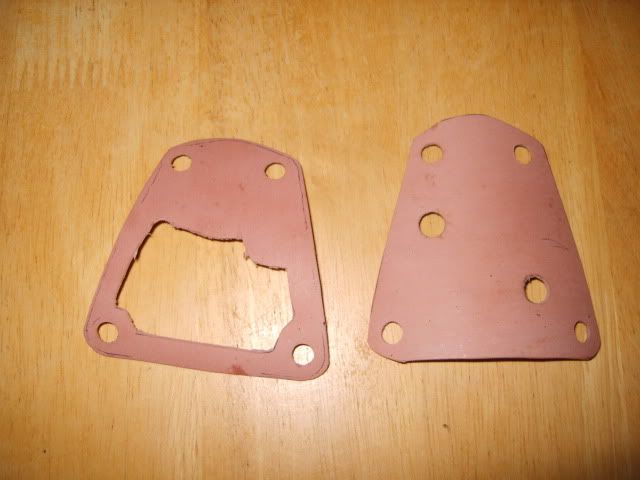

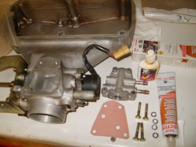

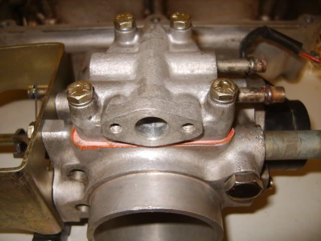

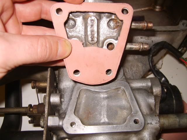

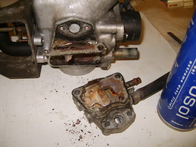

The picture of the final gasket is on page 58
You would need to read the passages about the problems he (john) faced and how we (various club members) solved the problem with him by a process of elimination and investigation on pages 56, 57 and 58.
The remnants
the first (incorrect) attempt
The pictorial evidence from exploded diagram
The second (correct) attempt
The final result
