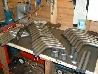

help me round a few bends pls.

If you use the latest serp front cover you will need the different sump however if you use the interim 3.9 front cover it uses a normal sump and pick up pipe and would bolt straght on. Thats the one i've used.
depending on patience and fab skills, you could make your own headers. Custom Chrome (the cherry bomb people) sell a header kit that gets you a selection of bends to make something up.
Certainly not quick or cheap - but depends on what floats your boat.
