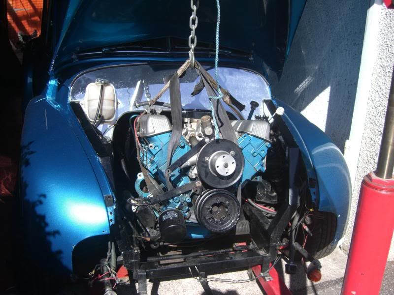

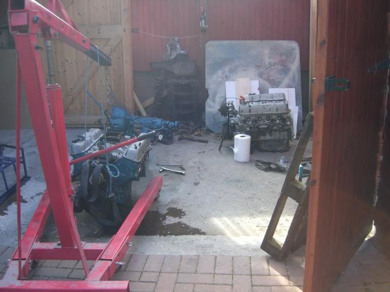

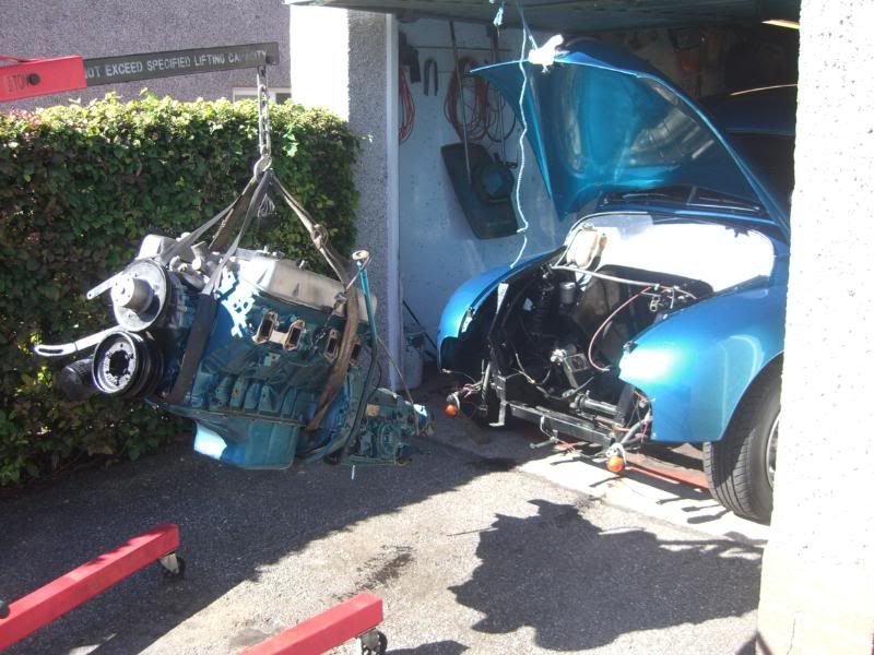

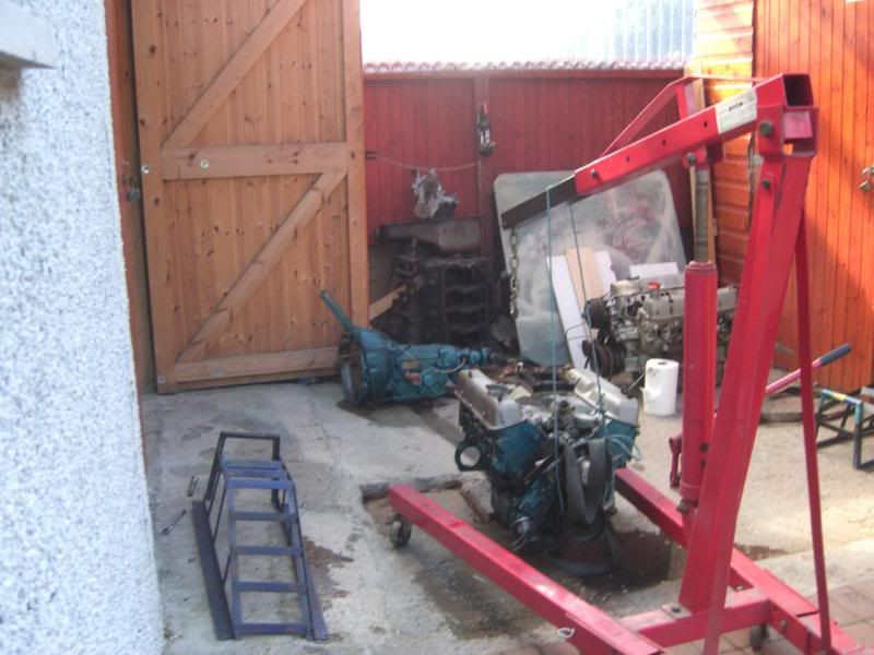

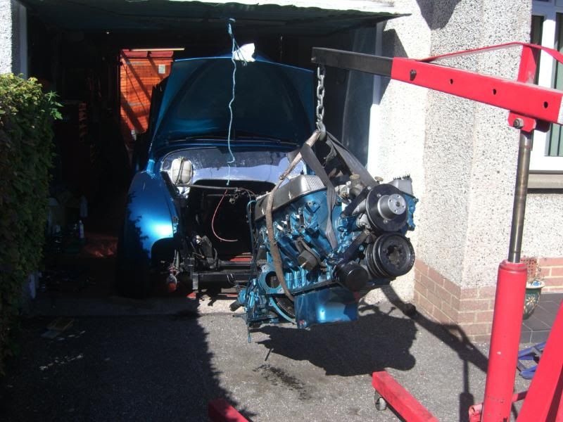

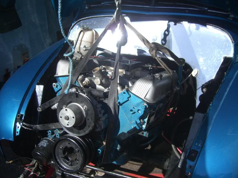

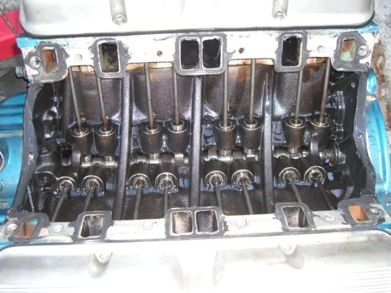

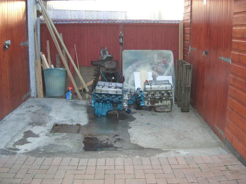

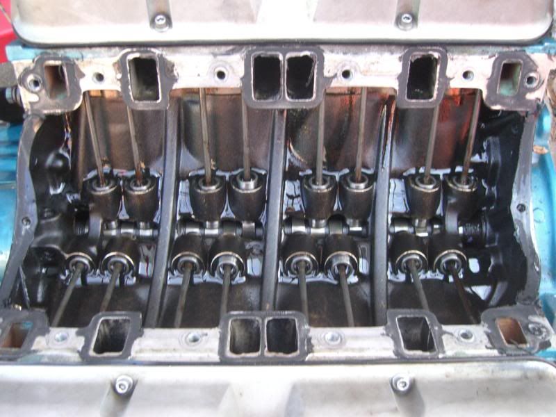

Engine out today and I decided to fit my SD1 front cover to the new engine to see if it pumped oil. To my surprise it primed instantly (better than the one it was fitted with) and went over 40 psi at lowish revs.
I then fitted the new engine's front cover to my old engine and whilst it primed ok, there wasn't much flow to the cam followers - seemed like I was getting cavitation when I upped the drill revs.
I'll whip the sump off my original engine and see if there's any shells left, and hopefully find out why it's been misbehaving.
My original engine is a really clean unit compared to the new one, so it will be decision time soon. Looks like my new cam is still in one piece though, so can be swapped if need be.

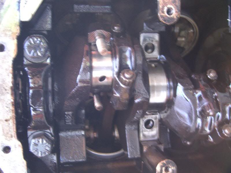

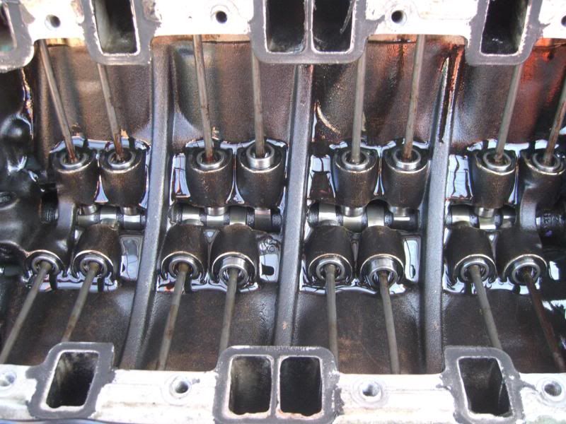

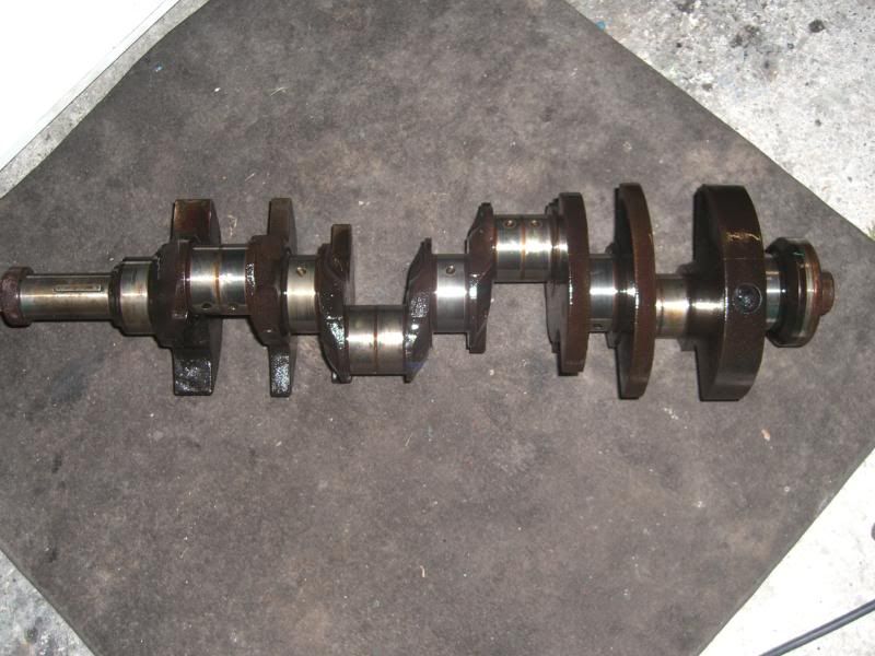

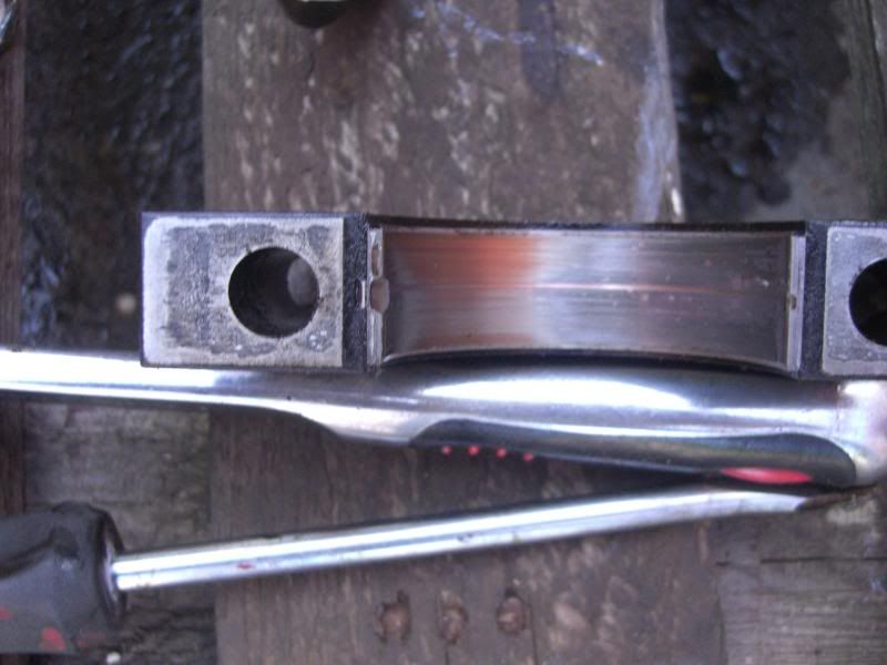

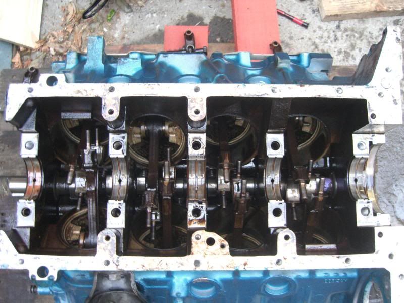

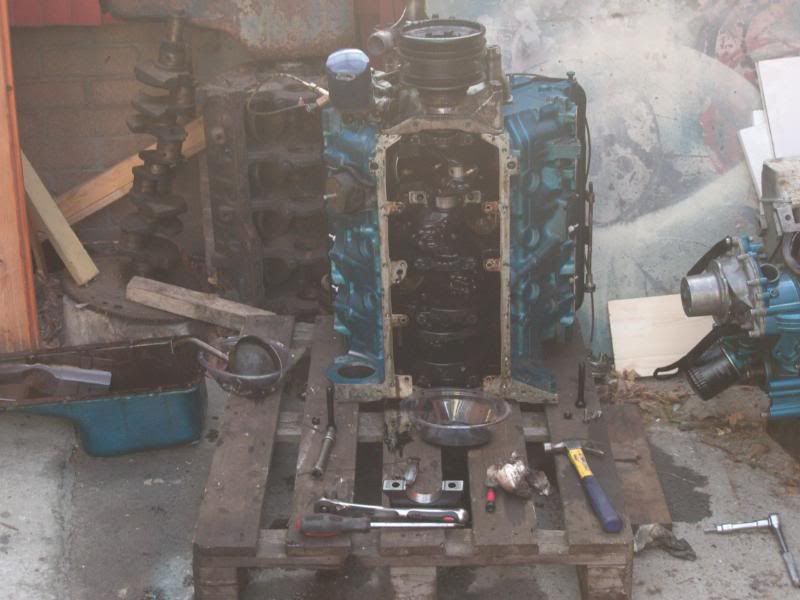

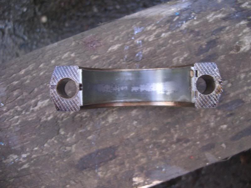

Took the sump off the original engine today to see if I could see the problem. It was immeditely obvious once I took the baffle plate off - the pickup gasket hadn't been fitted correctly and masked half the intake hole. That's why it started to rattle when at higher revs - not enough oil getting to top end.
I then took off a big end and it didn't look too bad, but when I took a main off it was down to copper. Crank also has a bit of back and forward play, so the thrusts must be worn.
I'm thinking that I'll just reuse this engine and will whip the crank out without disturbing the top end (seems ok), get it ground and fit new bearings (I have +10 clevite 77 bearings to fit).
pics:
pics:
