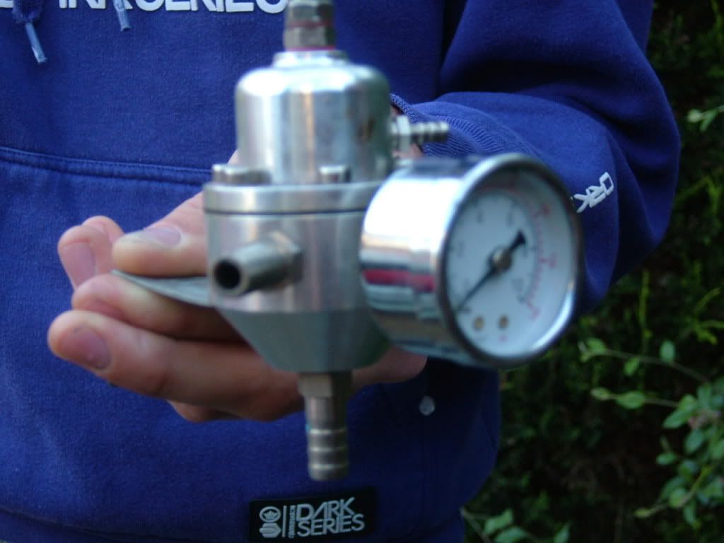

I have an 044 pump to fit and also have a regulator. But I'm not sure how the reg works yet or even how to pipe it up.
I want to get it right first time so I'm not going to rush anything.
The reg has a tapping for what looks like a pressure reference signal. But I dont know if this would be boost or vacuum?

What reg is it ?
Its one of these!
No name on the thing ??
Posts: 4081
No idea what make, but looks relatively normal
From rails to the port on the side. Return out the bottom to fuel tank
And boost/vac reference to the small top port. ( ie reference from intake manifold )
