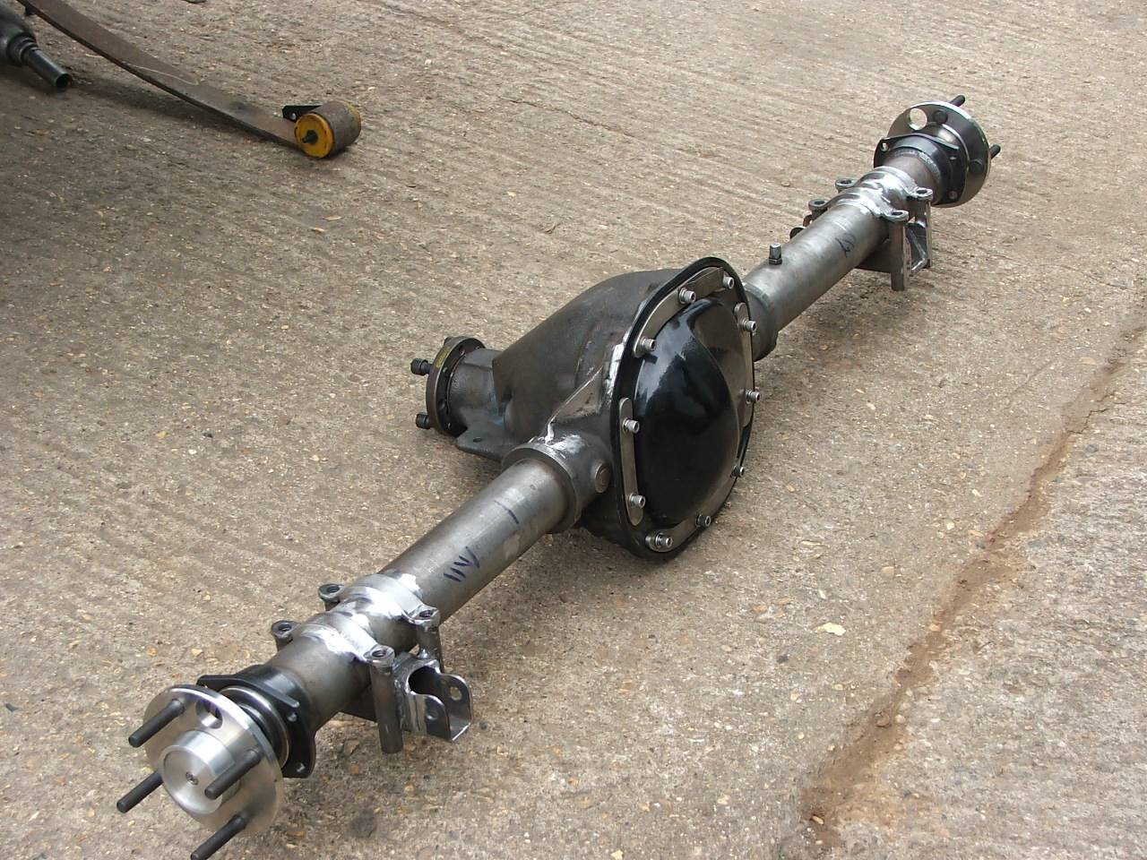

Axle sat waiting for final setup
2nd pic of axle

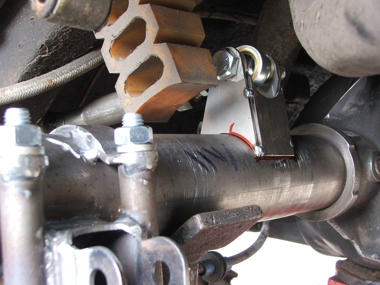

top fixing brace.
sat in position.
start of the top rose joint links.
second pic of top rose joint link, had to be at this angle to clear every thing, plus didnt want to start cutting into the shell,

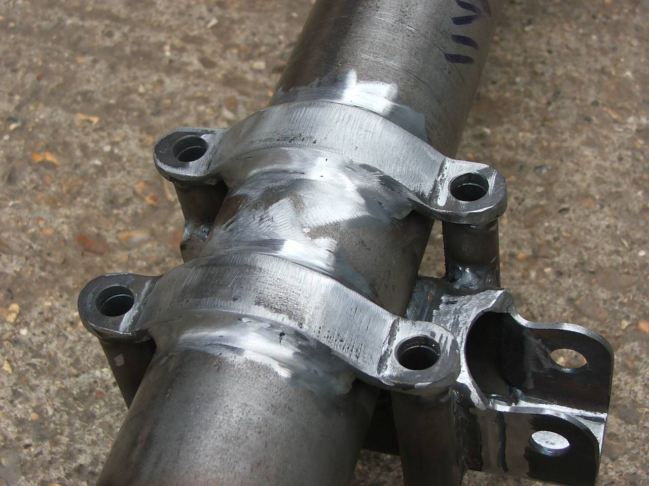

we decided to try something different, due to mot laws changing soon we didnt want to risk the 4 link set up just yet,
so to eliminate any twist on the U bolts we went for a solid billet base plate and 4x 12.9 grade allen bolts holding it to gether hope fully stopping any axle twist on the springs now,

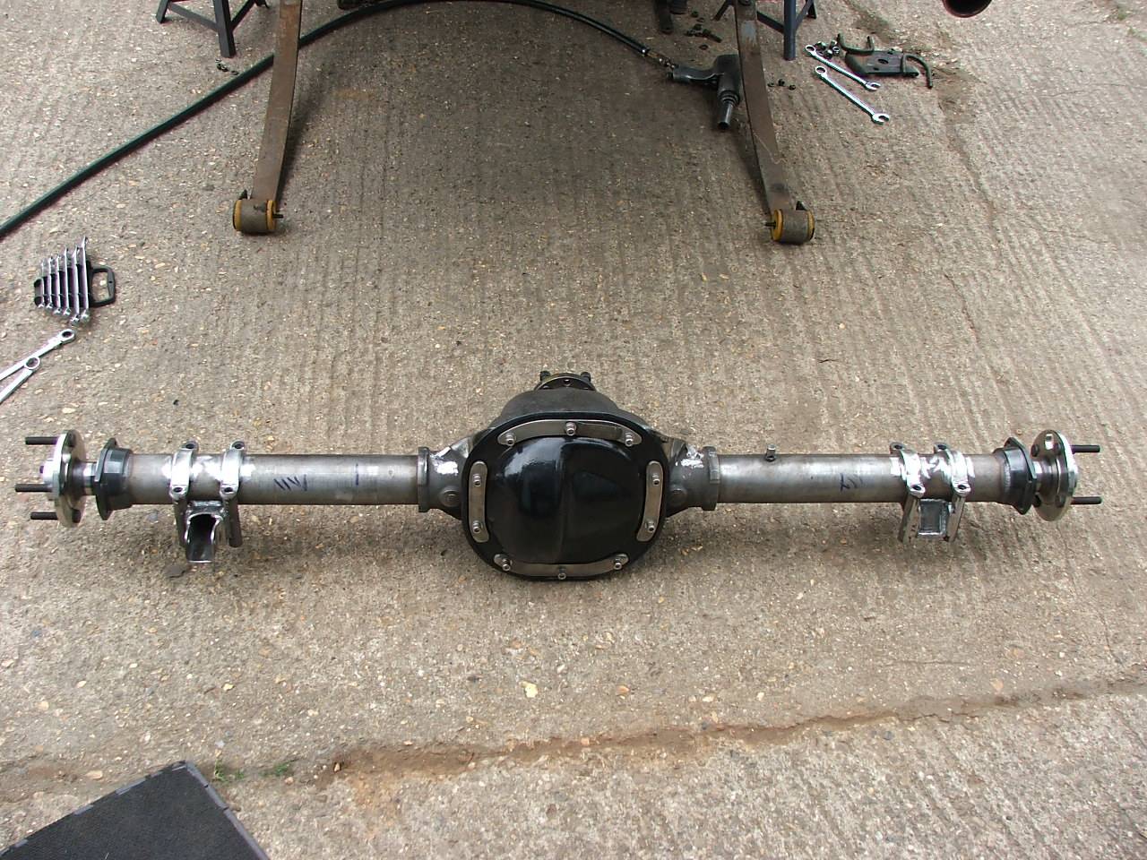

Nearly assembled,
Capri axle bottom new mussie axle to replace it top,

You're still using leaf springs and an additional upper link ?
Will the upper link not tend to make the axle rotate as it rises up/down ?

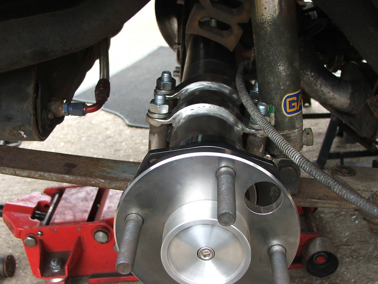

axle bolted in place onto the springs, and shocks bolted up.
New calipers fitted on the rear along with my cross drilled vented discs.(old seized caliper to the left)

The capri usually has an anti roll bar bolted to the top of the axle in a similar place.
Posts: 4067
Anti roll bar would have double links though. Rarely fixed on a single link, so no twisting like that can occur.
Again if overall axle travel isnt that much, and the link is placed fairly horizontal then there shouldnt be much twist. The longer the link the less twist again.
Same with a panhard rod. No matter what, it will always cause some side-side movement. Although generally it is quite small.
I think on mine it's only about 4-5mm sideways movement over the entire axle travel.
the anti roll bar was bolted to the top of the axle, and went to the same point the top link arm now does with a single rubber bush, same on the other side,
Posts: 4067
Weird. They must just allow the rubber to take up the movement. Normally all ARB's have a drop link of some description.
And never use rose jointed drop links. If you think your RJ upper links are bad, you should hear a RJ drop link on an ARB !!!!
I actually disconnected the ARB I fitted at teh back. You'd think the chassis was falling apart the noise it made.

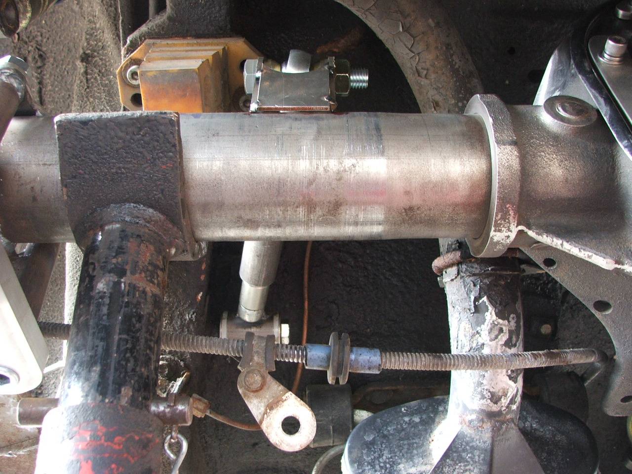

im going to run the car with top links removed the weekend to see if it is that making the noise or if the prop aint right,
this is a capri rear anti roll bar mate:
the two ends bolt to the chassis, and the two bushes in the middle bolt to the axle via U saddles.

right removed the top rose joint arms today and the vibration/noise stopped, so now im happy they can go back on,
BUT we noticed today they is a lot of back lash on the diff, you can twist the prop and make it clunk,
any one know the correct pinion back lash for the 8.8 before i ring up ARRC and moan and make myself look a twat if im wrong :lol:
Posts: 4067
The lash measurement is still fairly small. It's just the gears are bloody massive. There will be a noticable turn at the input flange before the teeth hit.
yeah thats what im getting mate quite a lot of turn at the prop before they mesh, thats normal then?
