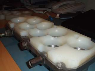

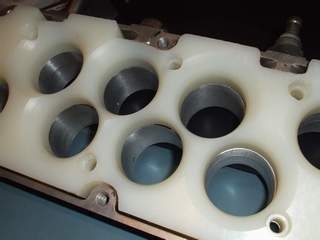

finished up making the plastic trumpet bases. made two; one is 40mm id for std manifolds (well - actually the OD of the steel trumpets - the idea is you cut them flush) - and a 44mm one which is tvr spec which requires work on the base to sleeve some of the bores.
I tried my hand at grinding a tool from a blank - which cuts the flares in one go - i'm pleased with the results. (amazed the damm thing actually cut rather than just push the plastic round in a molten blob!)

Thanks guys.
Ive updated the page with some ideas of cost. If anyone on here buys one - i'll donate some cash to the board.

Elliot very impressed with the nylon trumphetless base addition. However I cannot help questioning that the inner intake tracts will have an overall different length to the valves, the reason why the rover trumphets have a 15mm difference in height.
Looked at your site, very interesting.
adamnreeves wrote:However I cannot help questioning that the inner intake tracts will have an overall different length to the valves, the reason why the rover trumphets have a 15mm difference in height.
As i said before - I dont know what the effect of the uneven inlet tracts will be on the engine. The only way to understand it would be to dyno before after and read the plugs to check for even burn.
Look at the average cast exhaust manifold - not exactly a work of semitry either.
TVR Power remove the trumpets and blend the base (http://www.tvrpower.co.uk/taraka.php) - maybe they know the answer!
the effect of trumpet length will be related to the choice of cam and exhaust (and compression). On an engine producing less than about .8bhp per litre I doubt you will be able to detect any change at all by changing trumpet length by about 2 inches. Get above 1 BHP per litre then your cam/ head/ exhaust combination will mean that you will be trying to ballance all the cylinders in every aspect and the inlet tract length will become significant as will be indexing plugs, matching deck heights, rod lengths, chamber sizes and indexing the crank. With a cam timing below 240 degrees at .05" i would not worry, spend your time on the exhaust and heads.
