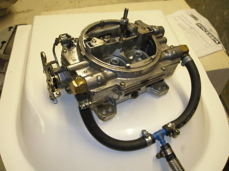

Im a big fan of the edelbrock 1404 carb but have to admit it took me a while to get things spot on. With my 4.6 I went down a size on the secondary jets.
One thing I should point out is that if you extend the accelerator pump arm you effectiveley shorten the stroke. For a bigger squirt move the rod inwards. (mine is set on the outside 3rd hole).
I have made quite a few modifications including removing the choke flap and the part of the airhorn that the flap sits on to smooth airflow into the carb. Also I have a double entry fuel inlet (one each side) with high flow float needles and seats.
I would say that mine feels as crisp and smooth as an injection setup.
Keep experimenting youll get there in the end.
Mark

Hi All
Have found some time to have a look at the carb tonight and I have been telling porkies!
The springs I have in on the rods are the orange ones.
MM has a comprehensive calibration kit and I will ask him to send me down the silver springs and I will give those a try.
As an aside I gave the car a run a couple of nights ago and when I gave it the normal throttle it stuttered and then all of a sudden it seemed to clear and shot off pretty quick.
Now this could have been just a bit of crud in one of the jets and it has self cleared in which case problem solved but I still want to give the silver springs a go.
Mark,I have removed the choke and other items as per your photo and ask whether you blocked off the holes for the shaft that runs through over the secondaries or have you left them open to the atmosphere?
They are clearly below the air filter housing and I think they should be blanked off but will bow to your greater knowledge.
Thanks for the help guys.
Paul
