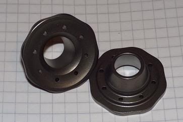

I need some advice. I need 16 retainers my new rover v8 head projeckt (7,9mm valve stem)
My local "motorsport" dealer has got 3 (4) type of retainers to suit my valves/keepers and spring.
Aluminium, Chrome-moly and also std steel type retainer.
Witch one is the best for fast street car?
Aluminium is light, but soft? Keepers can sink to retainer?
Std type is good for any tuned engine?
What about Chrome-moly? Any experience? Are they lighter that std type? What about durability vs std type?
Price is almoust same those 3 types.. About 10£ difference?
I use real steel valve spring, 1coil less than std? And also slightly more pressure?
Titanium retainers is also available, but price is enormous
