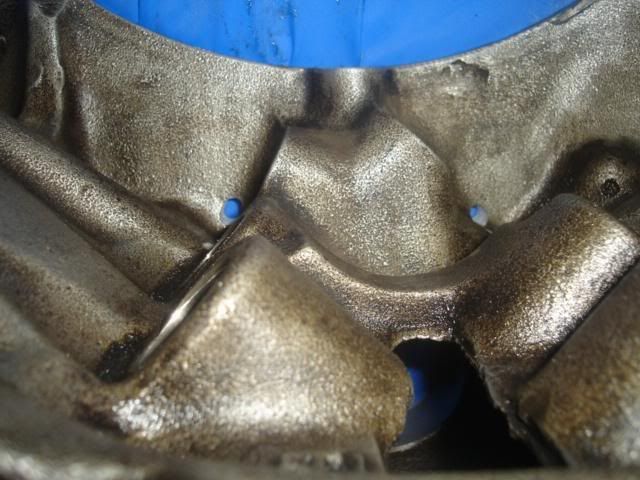

Yes its true and the holes go in the thick web in the valley at the front into the cam chain area. I don't know if I have any pictures of mine but I will look later. Whether it makes any odds or not I have no idea but its supposed to help oil the cam chain as well as oil drain. It doesn't cost anything to do so why not.
Ok had a look and I dont have any pictures after all the machining was done but I have done a picture with where the holes should be and the direction.

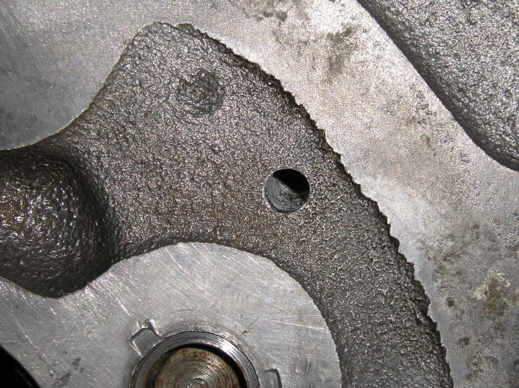

Take a look at the attached. You can see the holes I had put in my block.
Alex

This was one of the scariest things I'd done - kept thinking i was about to ruin my rebuilt engine by drilling into one of the galleries within the blockImage
[/img]Image
Image[/img]

The other thing you might want to consider is smoothing out the cutouts at the bottom of the V - below where the lifters sit. This also facilitates slightly better oil drainage onto the cam. I had this done on mine.
Looking at the pics attached to this topic, you can see that Marki has also had this done ( at least is looks this way ! )
Alex
