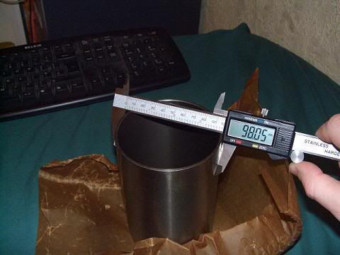

HairbearTE
Posts: 870
Location: Melton Mowbray
Post by HairbearTE »
Here's your measurement. Its a cheapo digi caliper not a mic but it gives you an idea of the dimension you'll be dealing with. To be honest a good machine shop will mic the liners themselves before fitting anyway, just to be sure they spec up right.
Wotland
Posts: 770
Location: Belgium
Post by Wotland »
Thank you very much HairbearTe for the measure.
