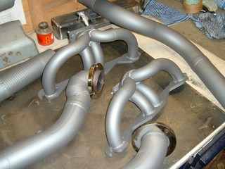

I have now fitted the engine and gearbox to my chassis and about to fit my block hugger manifolds.
I am looking for exhaust pipe suppliers, everywhere I have found so far only sell 1m lengths.
Does anybody know where I can get pipe, I'll probably need it mail order.
Also what diameter and gauge pipe is best to match my Rover V8.

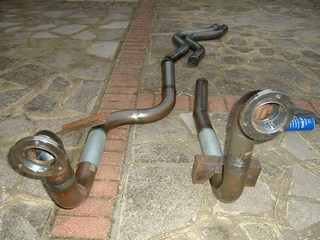

I bought all the components for my system directly from Jetex:
http://www.jetex.co.uk/website/jetexcus ... tparts.php
I only wish i got stainless because its all rusted to sh1t now.
POR-15 doesn't work (well it does, if you can get it to stick)
