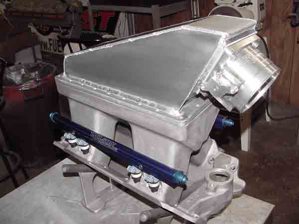

like this but with the throttle at a shallower angle;
nice eh?
topcatcustom
Posts: 2965
Post by topcatcustom »
I like the fuel rails
