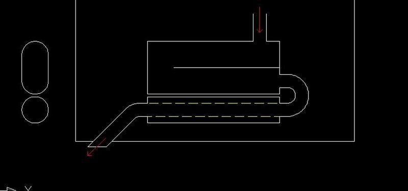

Cheers Ralph,
Using your available space/distances to best advantage there!
And making use of two of the three methods of noise reduction, - ie: Restriction and Reflection.
Just going "all around Will's Mother's" will generate both of the above and if you can somehow introduce a trace Absorbsion with some fibreglass filler then you may have enough noise damping to do the job.
If not you still have room to stuff a variable baffle, such as already described, up your tail pipe to de-tune the system, musically, to your needs.
You may even thinks its possible to wrap the outside with heat restrictive wrapping or ceramic to absorb even more decibels.
Also, it has the advantage of keeping the gasses hotter so achieving less unmovable mass than when they are rapidly cooled inside a thin pipe or muffler.
And don't forget, mild steel does not ring as loud as stainless steel.
Sorry about snowing you with ideas, but there is probably not one single thing that can achieve your goal, more a combination of little things adding up to something tangible.

i was aiming the first bigger box to be reflection as it will slow down as it goes through the bigger volume and there will be lots of walls for it to reflect off and hopefulyl cancel otu some of the noise.
the 2nd smaller box was goign to be a conventional silencer with a perforated pipe goign down the middle with fibreglass around it so that will do the absorbsion.
hoping to apply as little restriction as possable on this for obvious reasons.
