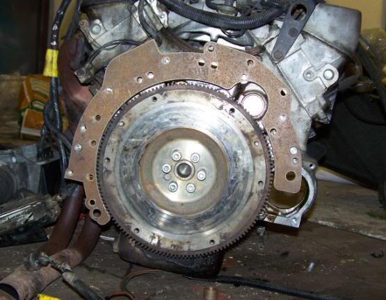

im using a different flywheel to what was origanly on the engine, therefore the PCD is different on it to what needs to be to fit the crank, the ways of doing it seem to be...
make adaptor, which i have seen in other peoples builds, basically bolts on with oneset of bolts, and then has threads goign in to it and the flywheel bolts to it.
re drill between the existing bolts ont he flywheel.
since holes are only 1-2mm out i could re drill them so the bolts will fit through, after all they are only clearence holes and it centers on the inside not the bolts.
make new flywheel, not exactly rocket science, but would be bit of a pain in the arse. could use ali tho.
the flywheel center hole is 0.07mm smaller in radious and will almost go on to the crank anyway, would fit with tiny bit of work.
any ideas on what would/wouldnt work?

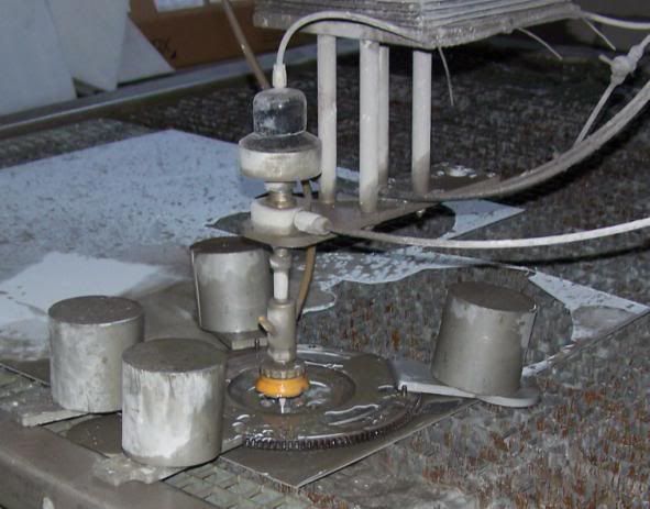

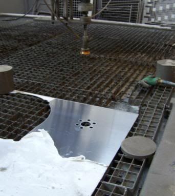

first i cut the inside hole (which i didnt need to cut from the flywheel) and the 6 sourounding holes from a sheet of cheap ali.
then lined the flywheel up over the holes so it was in the right place, this way can place it within few tenths of mm, and fire!

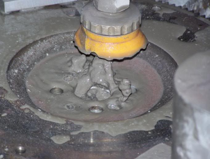

just thought this one stopped the water quite well...

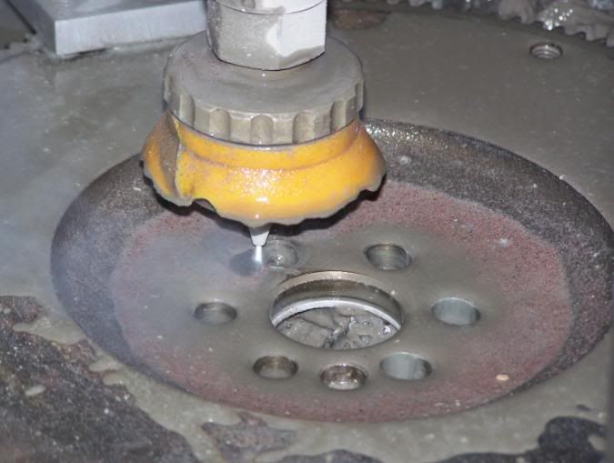

can just about see it cutting....
also cut a spacer to go behind it, which needed slight attention with a file as the holes where very very close fit, and it almost fits, 2 bolts went through perfect rest went throught he flywheel but where jamming as going through the spacer so very very slight fetle needed!
