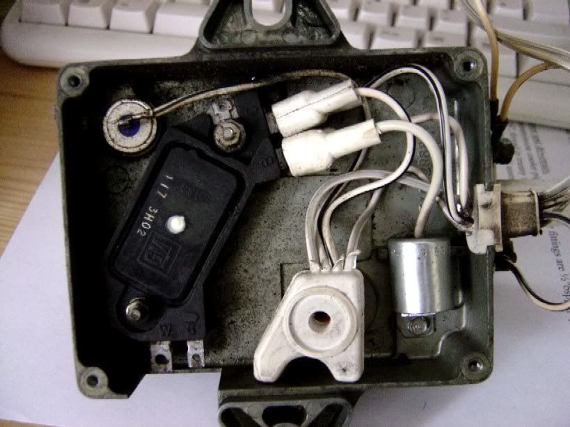

If memory serves correctly, there is another connection on the amplifier. The 3 pin plug you refer to has white (+12V ign), white/black (rev counter feed, coil -ve), and ground.
There is also a 2 pin connection on the amplifier, and you need a lead to go between that and the 2 pin connection on the distributor.

If you look at the bottom pic in the post from Paul B, there are two spade connections on the black module, lined up with a slot in the case. You should have a cable that goes from that to the two bullet connectors (1 male, one female) on the lead from the distributor. Have you got that? I think the wires are red & blue.
Then the 3 pin connector (is it circular) should have white (ign +12, coil +ve), white / black (coil -ve & rev counter), and earth which you have found already.
If that makes no sense, have you got any pictures of your setup?
