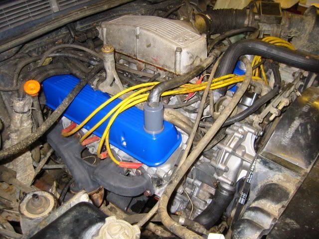

After what seems like an eternity getting all the parts together and finding time to build it I finally fired up my new 4.2 tonight, and what a fine feeling that was!! It started straight away, good oil pressure and it's as smooth as silk. I'd forgotten just how good the old Rover V8 can sound with only 1 small silencer :D
I can't wait to take it out for a spin, as soon as I've fixed the leaking radiator! there's always something isn't there :x

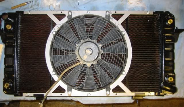

I found out that reason the rad was leaking was the 'cable ties' used the mount the Pacet fan had worn through one of the fins. I tried to repair it but couldn't get it to seal so I ended up buying a new rad. I thought I'd make a new mounting bracket for the fan to stop this happening again.
This is what I came up with:-
Fired it up again tonight and it all seems ok this time, test drive tomorrow, can't wait!!

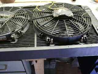

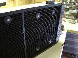

Another way of mounting fans to a radiator if your'e having one made is to have tubes soldered into the core, Kempston radiators done this for me:
