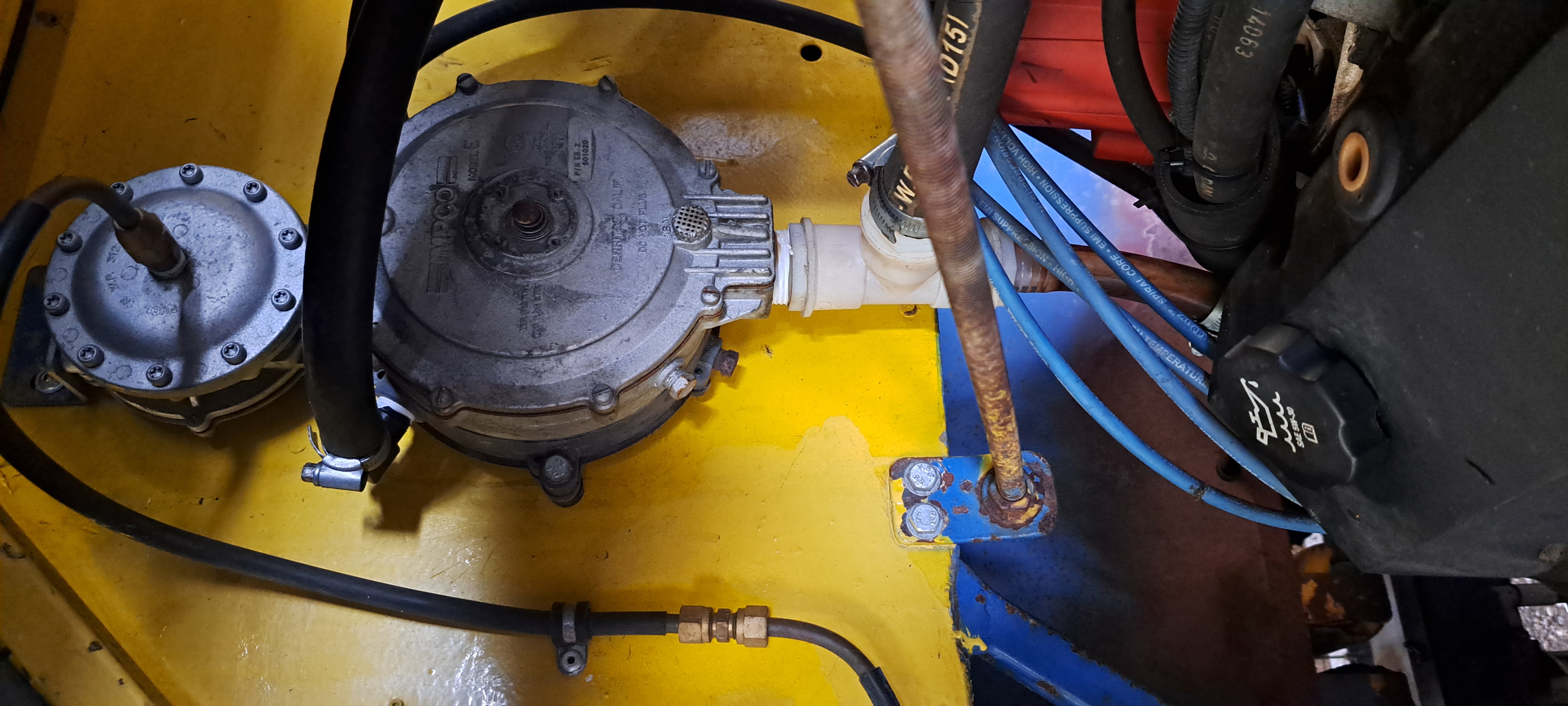

Hi, thank you for the help.
There is nothing that has changed that I am aware of with the set up, we have been operating it for a number of years and haven't had any issues yet.
Weather wise, it seems to be worse in cold weather but only occurs after some use, when under load and running at its normal temperature.
I've attached some photos with the set up that we have, is there anything that we should look at?
